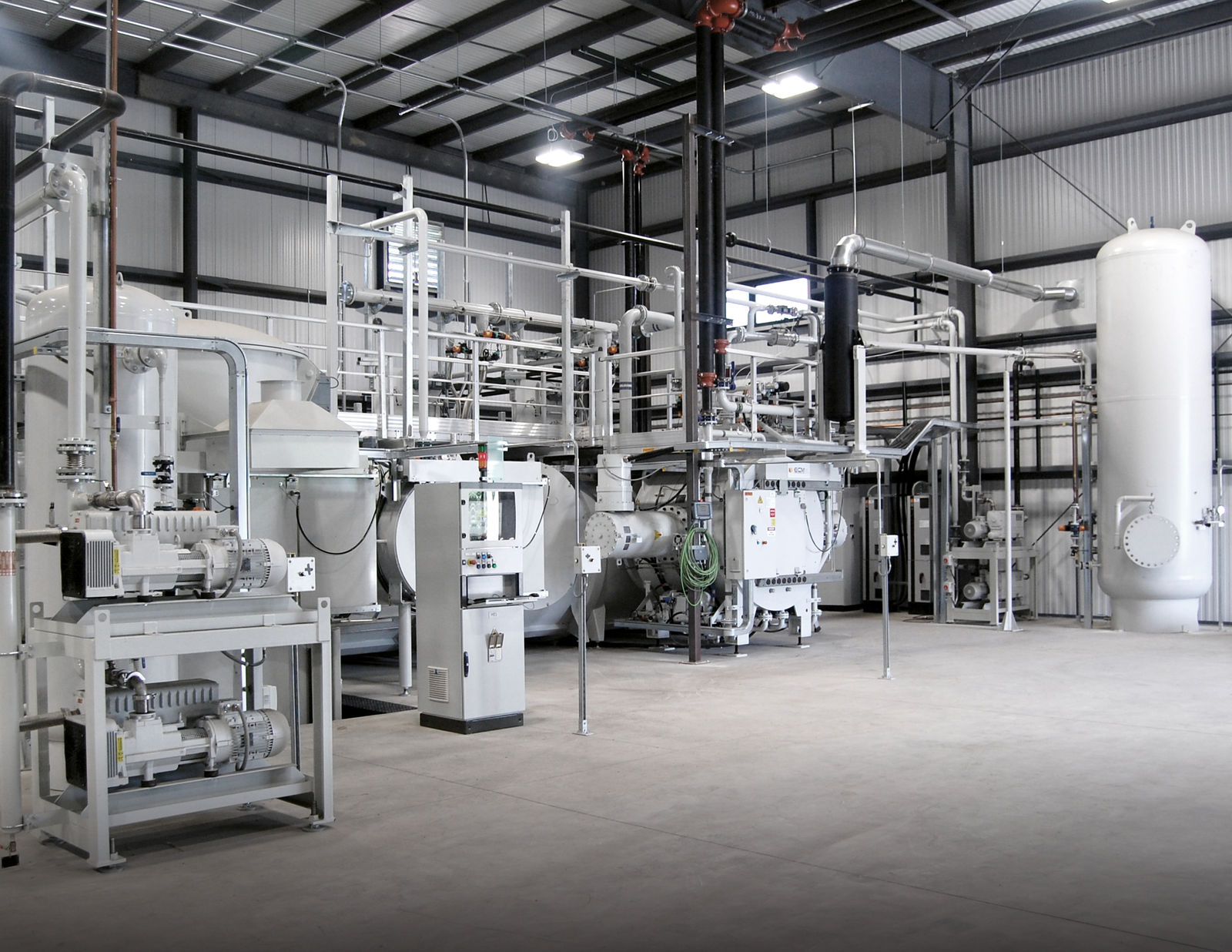

Nitrex2.jpgModern high production low pressure carburizing furnaces at Nitrex HTS – Aurora, IL.

Mixing gases in vacuum? Yes, this is very important. Vacuum carburizing is performed in a pressure range of around 10 mbar (1,000 mbar is atmospheric pressure). When a gas is introduced into such a “vacuum”, the gas will behave in an ideal manner and expand to fill the space where there are no gas particles. In effect, this is mixing without the need for fans. This is because, during evacuation, there are less collisions of other gas particles as we evacuate more and more particles. This means blind holes will fill with gases by definition. The process is more complex, but this is a guiding principle. There is an excellent article on this concept (Ref. 7).
Most vacuum furnaces today are designed with water-cooled walls, and they use carbon and graphite insulating and heating element materials. These furnaces are easily designed for constant use at over 2,000°F. Most atmosphere furnaces struggle to not deteriorate at 1,750°F, as they use “high temperature” alloys, and the carbon gases and high temperatures attack and degrade these alloys. Few commercial shops will gas carburize at 1800°F and above, even though it is faster. As mentioned before, there are very few exotic nickel or cobalt alloys that perform well, long term, in a carburizing atmosphere and at temperatures of 1,850°F or above (Figure 1).

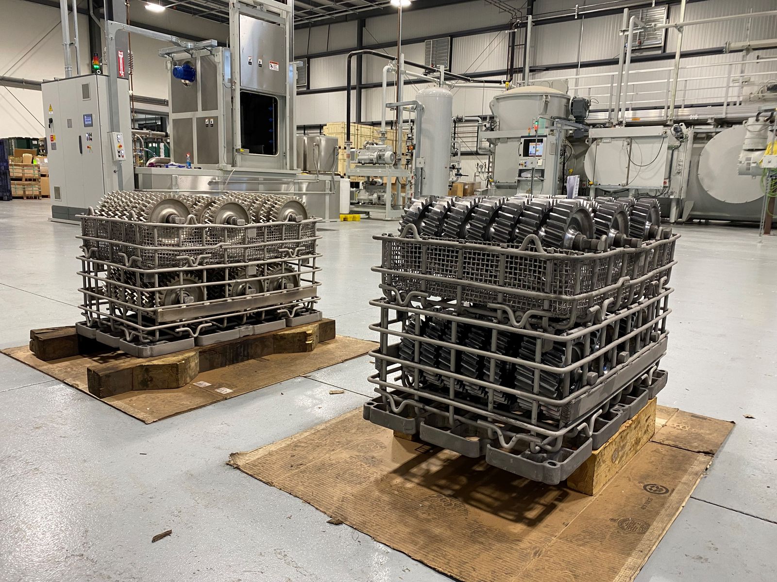

Nitrex3.jpgIn order to maximize weights and use higher temperatures, rethinking load tooling is a requisite.
Fixtures for any furnace can get expensive and this fixture tooling is often bulky, heavy, and made from the same alloys that we have been discussing. As well, high temperature alloys that can survive a carburizing atmosphere and constant oil quenching stresses are not cheap! Constant oil quenching and high temperature carburizing are very destructive to alloys. Throw in the higher process temperatures desired with LPC, and we have problems. But the worst one is that we are using heavy alloys and reducing the ability to add parts to the load that can be processed and make money, due to the load weight limitations of any furnace.
As mentioned before, LPC has three loading limitations — surface area, separating parts properly, and weight. Alloys are heavy and, at high temperatures, tooling fixtures need to be built bulky and heavy. This reduces as much as one third of available load capacity.
CFC fixtures can be as much as 10 percent of the weight of alloy fixtures. So, in a 1,500 lb. maximum load, if alloy fixtures were 500 lb., then we could save over 400 lb. and use that extra load for money making parts instead (Ref. 5).
CFC, unlike alloys, retains its strength at higher temperatures, so it can be built without designing for temperature-related substantial reductions in strength, as with alloys. At these high use temperatures, alloys exponentially lose their strength. As well, CFC fixtures can easily handle process temperatures up to 2,000°F. The only limitation with CFC relates to contact points with metal parts at elevated temperatures (Ref. 5).
CFC is not as “robust” as alloys in the day-to-day rigors of running a heat treat operation. For this reason, combinations of CFC-alloy designs for fixtures also have been used. In Figure 4, we show a more robust cast tray made of a high temperature alloy, with the CFC fixture mounted on top. This uses the strengths of both designs and accepts some heavier weights as a trade-off to increase robustness, limit breakage and ease transferring loads at high temperatures. The article (Ref. 5) discusses CFC fixtures, oil quenching and tempering.
