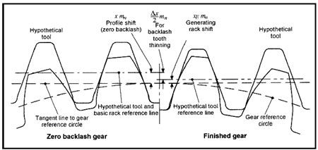

When manufacturing a gear, the cutting or grinding tool may be fed in or out to make a size change. What this actually does is make the teeth thicker or thinner, at the standard pitch circle (gear reference circle). The standard pitch diameter, however, doesn’t change. See Figure 1, which appears as Figure B.1 in AGMA 913-A98, Method for Specifying the Measuring Geometry of Spur and Helical Gears. The right and left halves of this drawing show the relative position of the cutting tool and the resulting change in tooth thickness. Note that the standard pitch circle (gear reference circle) doesn’t change.

smith1 Figure 1--Hypothetical tool with zero backlash and finished gear. (Extracted from AGMA 913-A98 with AGMA permission.)
