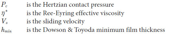

Boundary friction coefficient is taken from empirical measurement (Ref. 7) and set at μB=0.1. The EHL friction coefficient is assumed to be dominated by the sliding loss component (Couette) flow and rolling loss and elastic hysteresis is assumed to be negligible. EHL friction coefficient is then defined as:
where

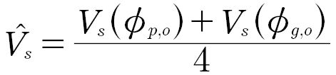

With the effective friction coefficient defined the power loss can then be described at the work due to sliding across the two surfaces. For a gear, the sliding velocities vary linearly with the contact roll angle. Average sliding velocity can therefore be defined as
where
