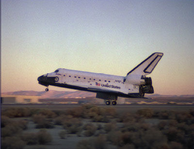

Space shuttle Discovery makes a perfect early morning landing at Edwards Air Force Base. It marked the successful end of the Return to Flight program, in which the Glenn Research Center played a vital role.
