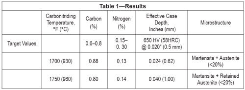

Additional LPCN tests (Fig. 5) were conducted at higher temperatures to investigate cycle time savings. Typical carburizing temperatures of 1,700°F (930°C) and 1,760°F (960°C) were selected for study. Process parameters were similar to the trials at 1,615°F (880°C). GDOS profiles were conducted to determine the nitrogen content at the near surface up to 0.0012" (30 ìm). Results indicated a nitrogen content of 0.5%, falling rapidly to 0.15% below the near surface at 1,700°F (930°C) and the same behavior was observed at 1760°F (960°C). The nitrogen profile was achieved at 1,700°F (930°C) up to 0.015" (0.4 mm) and up to 0.40" (1.0 mm) at 1,760°F (960°C). These tests indicate that the process can work at high temperatures as well.

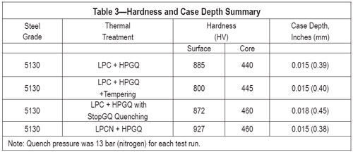

Hardness and effective case depth results (Table 3) achieved targeted values. This confirmed that there was no metallurgical difference to influence fatigue strength results.
