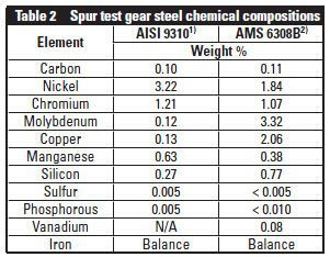

Test Gears
NOTES:
1) Nominal composition per specification
2) Verified composition and within specification.

All gears included in this study were made from forged bars; the gears were made from two alloys. One alloy was per specification AISI 9310, the other per specification AMS 6308B. The chemical compositions of the two alloys are given in Table 2.
NOTE:
1) Denotes Rq calculated from published Ra values.
All of the gears made from AMS 6308B were made from a single melt of vacuum-induction melt vacuum arc re-melt (VIM-VAR) processed steel, and were manufactured as a single lot; i.e. — all rough machining, hobbing, heat treatment, and final grinding were accomplished together as a single lot of gears. The gears made from AISI 9310 steel were from two melts of steel; one melt made via air-melt vacuum-arc-remelt (VAR) process and the other melt made using a consumable electrode vacuum melt process (CVM). One can expect that the CVM-processed steels had fewer impurities than did the VAR steel. The gears made from the VAR 9310 were manufactured in one lot; those made from the CVM 9310 steel were made in three lots. Gears were case-carburized and tempered following aerospace practice to achieve a surface hardness of minimum Rc 58 — with a typical surface hardness of Rc 60 and case depth of 1.0 mm (0.040 inch). Additional details concerning the heat treatment process, typical microstructure of case and core, hardness profiles, residual stress profiles and surface metrology are available in (Refs. 13, 14, 21-22, 23 and 27).
