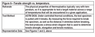

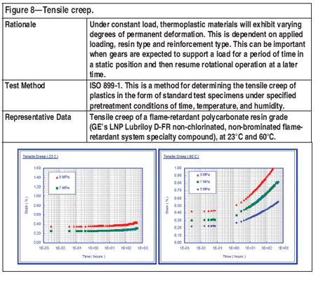

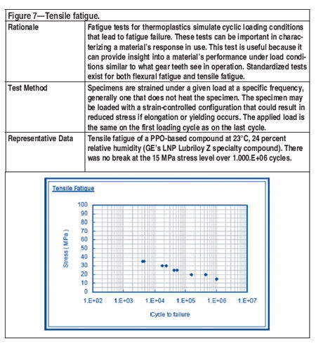

“Today, gear designers typically have to rely on material performance data derived from standardized (ISO) testing, provided by material suppliers to be used across all applications,” he says. “The problem is that this data is not specifically relevant to gears, so the resultant gear designs and material selections are often unnecessarily conservative, leading end-users to reject plastic-based gear systems that may offer the best, most cost-effective solution.”

“Plastics don’t behave like metals, so it is always difficult to model plastics. You can’t just pull data and trust it,” he says. “Plastic tensile strength standards—such as ASTM D638-03 (ISO 527-1)—give an approximation only. ASTM test bars, which all suppliers use, fall far short of a gear in determining actual performance.
“Better is to get the wear and strength data from actual gear testing. Some, but not many, of the material suppliers are working on compiling that data.”
