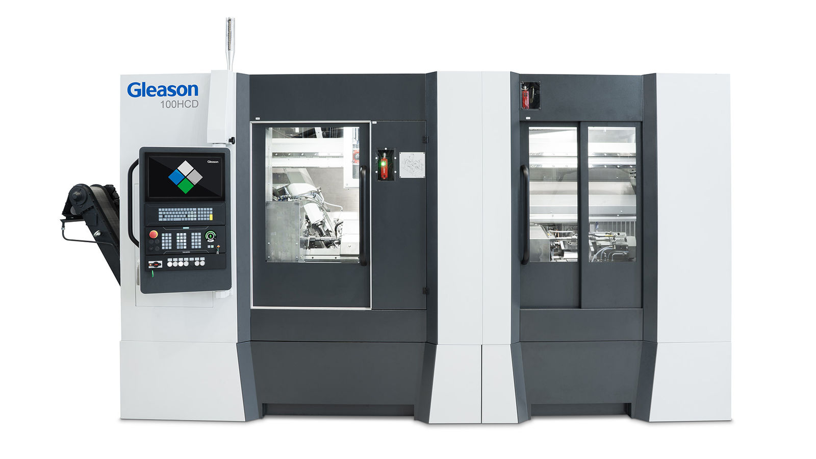

The 100HCD is designed for a wealth of geared profiles up to a workpiece diameter of 120 mm, module 4, and a shaft length of 450 mm.

The 100HCD is a variation on Gleason’s recently developed 100H horizontal hobbing machine—the next generation of the well-known P90 Series, with improvements in design, functionality, and operator interface. This new series, including variants such as the 100HCD, is designed to handle a wealth of geared profiles up to a workpiece diameter of 120 mm, module 4, and a shaft length of 450 mm. With design improvements to the hobhead and workspindle and the use of the Gleason GEMS human-machine interface (HMI), the 100 series delivers extremely fast cutting and processing times, making it a good match for the large batch production of gears and pinions. And like the P90 series, which integrated chamfering/deburring along with horizontal hobbing, the 100HCD also combines this new and improved hobbing platform with an integrated chamfering/deburring station.

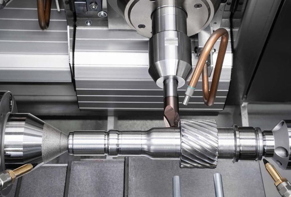

With radial chamfering, available now in parallel with hobbing on the 100HCD, the chamfer is produced with a cutting process using one or two single-point cutting tools. This eliminates subsequent operations needed to remove the secondary burr that often resulted from the chamfer rolling process used in the past.

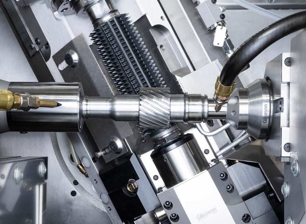

With radial chamfering however, applied in parallel with hobbing by the 100HCD, the chamfer is produced with a cutting process using one or two single-point cutting tools, rather than rolling, thus eliminating a subsequent operation needed to remove excess material in the form of the secondary burr that can result from chamfer rolling. With cycle times and tool cost per piece of paramount importance, the replacement of chamfer rolling with radial chamfering makes perfect sense. And while Gleason’s chamfer hobbing process—first introduced with the 160HCD and the 280HCD—is ideal for disc-type parts, radial chamfering is better suited for shafts typically produced on a horizontal hobbing machine of this type. These shafts, often with the root diameter of the chamfered gear and the shaft diameter in very close proximity, are inherently more difficult to chamfer and deburr due to the clearance requirement. The hob-type cutting tool used in the chamfer hobbing process, while ideal for disc-type parts, makes it challenging to chamfer shafts with interferences typical of those found in today’s most common e-drive transmissions.

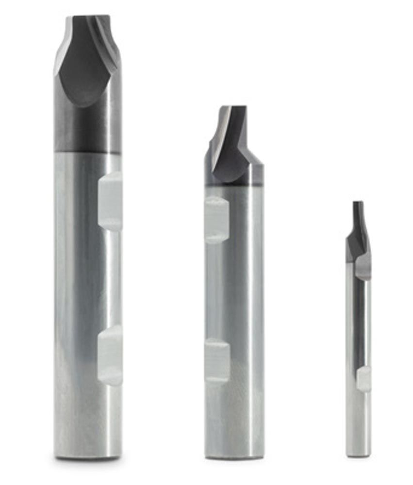

Gleason’s radial chamfering process uses economical, highly productive resharpenable carbide cutting tools, with from one to three cutting edges.
The 100HCD operates similarly to its P90CD predecessor. By performing chamfering/deburring in parallel with hobbing, it delivers a remarkable cycle time, with the assistance of highspeed gantry load/unload automation and Gleason workholding with a very fast clamp/ unclamp capability. The gear is first hobbed and the rough burr that results from hobbing is removed in a single setup at the hobbing station. The gear then is unloaded by the gantry and loaded into the chamfering/deburring station, where radial chamfering is performed simultaneously while another gear is hobbed. Depending on the application requirements, the chamfering station can be equipped with a single-tool spindle or an optional two-tool spindle for single or two-tool radial chamfering. Economical, highly productive resharpenable carbide cutting tools, with from one to three cutting edges, and sourced through Gleason are used in both cases. A single tool can be designed for chamfering the gear flanks, with or without root chamfering. The two-tool option adds more flexibility to influence the chamfer angle with tools specifically designed for the obtuse and acute edges (particularly advantageous in the case of gears with high helix angles where obtuse and acute angles can be quite different) to meet a customer’s specific design requirements in advance of the subsequent hard finishing operations. In both cases, radial chamfering is fast and efficient, with no impact whatsoever on chip-to-chip times since the operation is performed in parallel to the hobbing of more workpieces.

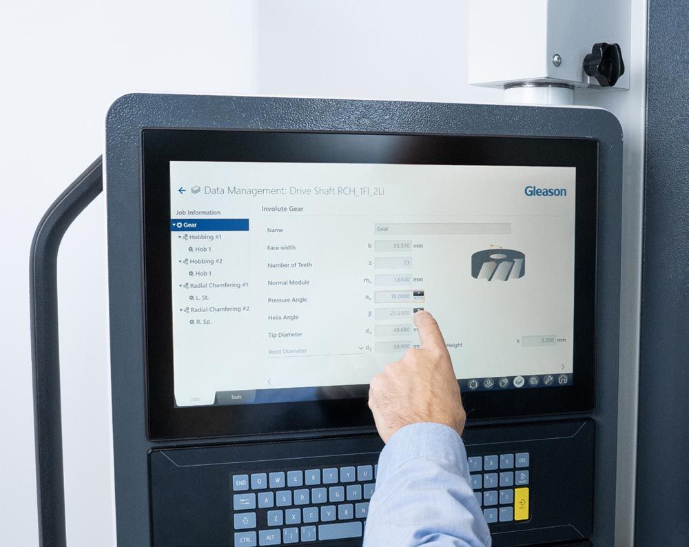

Shorter cycle times and more efficient, error-free operation also result from Gleason’s GEMS HMI hobbing software, which makes setup and changeover more intuitive and simpler to both learn and operate. This HMI, coupled with the latest Siemens Sinumerik One control, provides several new process options and guides the operator intuitively through the workflows of the machine, both hobbing and radial chamfering.

Coupled with the latest Siemens Sinumerik One control, Gleason’s GEMS HMI hobbing software guides the operator intuitively through the workflows of the machine, both hobbing and radial chamfering.
