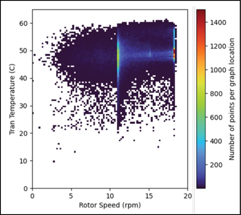

SCADA Data and Lubricant Analysis
In reviewing the details of the Method B results from the previous paper, questions were raised regarding the gear drive operating temperature and lubricant condition. This gear drive was well-monitored during its operation. To better understand the influence of its application conditions on the presence of micropitting, three different factors were reviewed:
  • Operating temperatures. Data were available for the temperature of the oil sump for approximately 7.5 years of the 8 years of operation. Oil sump temperatures ranged from 20⁰C to 66⁰C, with the densest cluster being between 40⁰C and 60⁰C, as shown in Figure 5 [16]. Later measurements on a replacement gearbox showed the temperature of the outer race of the high-speed-shaft bearing, one of the highest operating temperatures in the gearbox, did not exceed 70⁰C [19]. Based on this, calculations for the sun pinion were performed with a normal oil temperature of 50⁰C and a worst-case temperature of 70⁰C.
    Figure 5—Oil sump temperatures (Ref. 18).
  • Load cases. Wind turbines operate under varying load conditions. The previous paper applied the mean load condition to calculate the micropitting safety factor. In order to gain an understanding of the running loads that affected the gearing, the operational torque and speed data were mined in both one-second and 10-minute intervals (Ref. 18). The largest amount of time the turbine spent was actually in idle mode, in which the rotor speed is 0–1 rpm and there is no load of the grid operating time, there were high numbers of data points at rotor speeds of 11 rpm (cut-in speed) with loads under 20 percent and 18 rpm (rated speed) at loads ranging from 40 percent to just over 100 percent. An additional collection of points was seen at 13 rpm and relatively light loads under 25 percent. Based on this, it was decided to run calculations at these three load cases summarized in Table 5.

  • Oil condition. The NREL report on the gear drive condition [17] mentions that sludge was found in the filter during a late 2017 inspection just prior to removal of the gearbox. In order to determine whether the oil condition influenced the onset of micropitting, especially with respect to water content, the gear drive maintenance records were reviewed. Other than an unexplained brief spike in the water content in 2012, the lubricant condition is normal until the late 2017 inspection. The oil viscosity, particle counts, and water content were otherwise within recommended parameters [18]. From this, it was concluded that the lubricant was well-maintained, resulting in relatively cool, clean, and dry conditions and did not contribute to the micropitting.
  • Castrol Optigear A320 lubricant. The lubricant supplier was contacted for information related to the lubricant’s micropitting resistance. Castrol Optigear A320 has a FVA 54 failure load stage greater than 10 at 60⁰C and 90⁰C test temperatures. The permissible specific film thickness of this lubricant was calculated at an oil temperature of 60⁰C because that provided a more conservative calculation and was representative of the operational data for the wind turbine.
