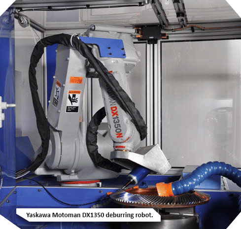

“Every time you hob a gear or grind a gear, you create sharp edges,” Klein said. “The sharp edges have to be taken out for safety reasons and also for mechanical reasons. You can do that with a grinding wheel on a drill, basically. You have air and you hook it up to an air gun and then the wheel spins and you just do it by hand, which we do quite a bit of that as well. Of course, by doing it by hand you’re risking that the hand operator is going to make a mistake and do it too deep or too shallow, touch something other than the tip of the tooth, whatever.
“One other way of doing it is with a robotic arm, because once you’ve programmed that arm to do it, it should do it repetitively. If you’ve got 60 teeth it’s going to do it exactly the same on all 60 teeth. It’s going to be repetitive and it’s not going to care. It’s going to do it over and over and over. It’s not going to get tired. It’s not going to vary.
“Of course, you have to program that into the machine. You have to develop that for each and every part. The tradeoff is that if you’re running a batch every hour, then you’re programming every hour, which becomes ridiculously time consuming, whereas if I’m doing it by hand the operator can adjust to every part no problem. So it’s a mix.”

“The robot — and I hate to say it, because I’m a robot guy — but it’s really a dumb device [in the case of gear manufacturing],” Glaser said. “But what we do is equip it with some very smart sensor technology. That’s really what has changed the landscape of robots in the gear industry.
“A six-axis robot today is not a whole lot different than the six-axis robot of 10 years ago. What’s changed is vision technology; what’s changed is force-sensing technology and calibration tools to achieve very high-tolerance deburring.
“The robots are the same but their capabilities are improving drastically.”
