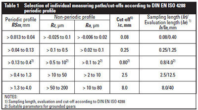

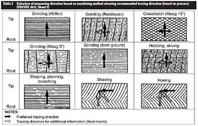

Refer to Table 1 to select appropriate individual measurement paths and cutoff. As finish-machined surfaces on tooth flanks in particular must be tested, the highlighted values should be used preferentially. The measuring direction for the roughness measurement should be selected according to Table 2, based on the machining method and the resulting structures.

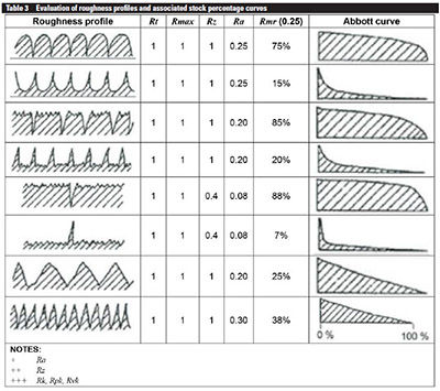

When selecting the appropriate parameters for the roughness measurement on tooth flanks, the stress on these surfaces due to compression and sliding must be taken into account. The parameter Rmax has little meaning for this stress, as individually projecting peaks, which are of little relevance for the load capacity, are taken into account here. The arithmetic mean raw value Ra is greatly distributed, but correlates the least with the function parameters and therefore should not be used. The preferred parameter for roughness on flank surfaces is Rz, as it provides a high degree of clarity and makes it possible to draw accurate conclusions about the height of the roughness profile.
In addition to the parameters that describe only the vertical expansion of the roughness profile, it is important to determine the roughness structure in order to determine the wear behavior or load capacity of a tooth flank. The stock percentage curve (Abbott-Firestone) and the resulting parameters Rk, Rpk and Rvk are appropriate for determining the structure of the roughness profile. A nearly S-shaped pattern in the stock percentage curve is ideal. Another appropriate parameter for the stock percentage is Rmr (c). See Table 3 for a comparison of roughness parameters and stock percentage curves.

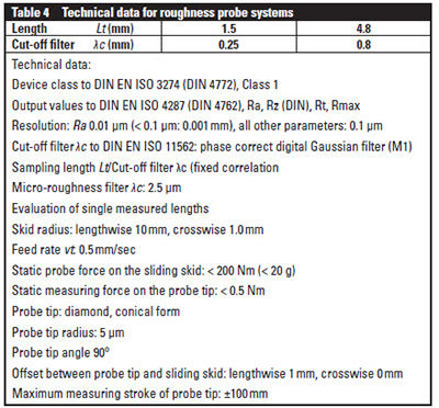

A standard roughness testing device (Ref. 3) is shown in Figure 9. In addition to a feed mechanism with a microprobe system, the device also features a cross-slide to position and test the workpiece. An additional clamping fixture is generally needed to test toothed gears. According to the figure detail, compact reference area probe systems with an application range from module 0.5 can be used here. A PC computing system with high-performance software is available to control and evaluate the roughness measurements. The evaluation software takes into account a large number of established roughness measurement standards. A report printout of the measuring results can be custom-designed.
Figure 9 Standard roughness test device — example stationary surface measuring station for gears (Mahr catalog).- Click image to Enlarge
One advantage of the device presented is that general workpieces can also be tested, and a higher standard overall is provided for roughness measurement. It does, however, require more set-up for flank measurements and the device is not suitable for large and heavy workpieces (500 mm in diameter, for example).

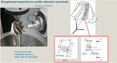

Application example: cylindrical gear/ bevel gear measurement on gear measuring centers. Gear measuring centers are typically equipped with a rotary table for testing rotationally symmetrical workpieces and are suitable for measured value logging on small to very large workpieces, in conjunction with a model series. As previously described, the measuring method used here is the involute reference in combination with a skid system.
For roughness measurement a special probe system on the adapter plate of the measuring machine’s macro probe system is adapted (Fig. 10). An additional electrical connection is provided for transferring the measured values from the integrated micro-probe system for the roughness measurement. For measured value logging in the profile direction, the probe skid rests on the flank to be tested and executes a movement similar to a normal profile measurement for the macrostructure of the flank. As it does so, a diamond needle located in front of the probe skid logs the measured values for the roughness measurement. The probe system represented here is also suitable for measured value logging in the tooth trace direction. The roughness probe system also features an adjustment mechanism enabling the probe needle to be aligned perpendicular to the surface for helical cylindrical gears as well.
Figure 10 Roughness testing device (cylindrical gear) on gear measuring centers — roughness inspection in profile direction (involute reference).- Click image to Enlarge
Thus in conjunction with an automatic probe change rack, a fully automatic process can be carried out for the roughness measurement in combination with other gear measurements. Because the measured value logging is controlled by the CNC-guided measuring axes, this results in highly precise positional accuracy and reproducibility for the measuring positions. The most important technical data for the integrated roughness test equipment are shown in Table 4.
