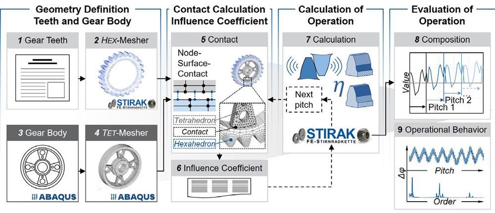

The consideration of gear body modifications in the calculation of the operational behavior of gears forms the basis for a successful design. For this purpose, the method for calculating the influence of the gear body was developed. The objective of the method is to calculate the influence of free gear body modifications on the operating behavior of cylindrical gears using the FE-based tooth contact analysis FE-Stirnradkette (Stirak).
Figure 1 shows the calculation method. In contrast to the gear simulation with partial segments of the gears, in the calculation of the gear body influence, the gear rim and gear body are comprehensively considered, so that the changed stiffness is mapped over the entire circumference. The number of teeth mapped in the simulation is reduced to the teeth that are in mesh to reduce the FE elements to be calculated. The material properties are defined linearly elastically by the modulus of elasticity, the poisons ratio and the density.
Figure 1—Method for calculating of the operational behavior.
The step-by-step procedure of the calculation of the operational behavior includes six steps. In the first step (step 1), the geometry of the gear rim and teeth is calculated with the FE-based tooth contact analysis and meshed with a parameterized FE hexahedral mesh, which is used to calculate the tooth flank pressure, tooth root stress and stiffness. The parameterized FE hexahedral mesh leads to an increase in the quality of results in the tooth contact (step 2). The gear body geometry is automatically parameterized in Abaqus CAE (step 3) and freely meshed with an FE tetrahedral mesh (step 4). The mesher available in Abaqus CAE allows the meshing of a variable gear body geometry.
The contact between the gear body and the gear rim is made via the extended node-surface contact with the SolverZ88 (step 5). In this process, the surface is additionally discretized with the Gaussian support points so that the location of the smallest distance can be determined as precisely as possible during the contact search (Ref. 16). If the distance is smaller than a numerical tolerance, a contact constraint is defined for the current contact pair and incorporated into the equation system of the finite element analysis using the perturbed Lagrangian method (Ref. 17). In this application, a bonded contact (i.e., a transmission of both normal and tangential forces) is required. With the bonded FE model of the gear, the influence coefficient are calculated in the sixth step (step 6), analogous to the general procedure of FE-based tooth contact analyses (Ref. 13). The load definition is taken from the FE-based tooth contact analysis and the gear body is bound in the bore. Then, the system of equations is solved with the SolverZ88 and the FE-based tooth contact analysis is used to calculate the operational behavior (step 7). The operational behavior includes the characteristic values such as the transmission error, tooth flank pressure, tooth root stress and efficiency. The gear body modifications lead to a circumferential stiffness variation in the tooth contact. Therefore, it is necessary to calculate and evaluate the gear body influence over one revolution of the modified gear. For evaluation, the calculation results are combined (step 8). In this way, the long-wave effects on the operational behavior can be evaluated. The result of the method is the characteristic values of the operational behavior over the revolution of the gear body–modified gear (step 9).
