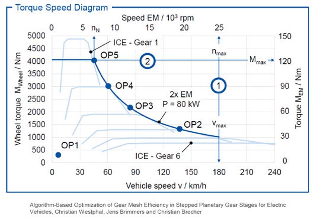

One of the biggest trends in the automotive industry today is the shift from internal combustion engines (ICE) to electric vehicles (EVs). Along with that trend, gear requirements are changing as well. The number of gears is expected to drop quite significantly. With ICE, there's an average of twenty-four gears in a vehicle, and eighteen of those are within the transmission. Whereas with EVs, there's only an average of about eight gears, which is about a third of internal combustion engines.
Furthermore, EV requires different types of gears. For example, electric vehicles operate at higher motor speeds than ICE vehicles, requiring a much finer gear flank finish to reduce friction and improve gear transmission efficiency. Shown in Figure 1 is a typical curve of vehicle speed versus torque, and the shift points that would be normal in an internal combustion engine with a conventional transmission. In an EV, the electric motor would have to operate across this range of speeds, so it is a lot more demanding on the gears.
Figure 1
The noise level of gears is another consideration. Gears for EV have a unique challenge because there is no noise from the internal combustion engines. Any noise generated from the gears is not going to be masked, so they have to be considerably quieter. To address this, both sides of the gear flank must have similar performance with tight tolerances on both the acceleration and deceleration sides because of regenerative braking.
