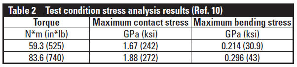

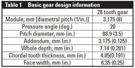

The test results described in this report were from the same lot of gears manufactured to the basic gear design information provided in Table 1. The gear material was an aerospace gear steel (Ref. 9) that was carburized and final-ground; the surface roughness was 0.41 micro-meters (16 micro-inch) or better. The gears have some tip relief starting at the highest point of singletooth contact and a small amount of crowning across the face width that is symmetric.
Five test results are described in this report. The tests in the loss-of-lubrication condition were conducted at one of two load levels, and are documented in Table 2. The basic gear design information, along with the load level, produced maximum levels of bending and contact stress, found via the analysis technique in Reference 10.
An example of each of the two load levels will now be described.
At the lower level of the two loads, two tests were conducted with the loss-of-lubrication time of 40.8 and 43.1 min in length. The data from the static thermocouples imbedded in the shrouds, along with other facility temperatures, is shown in Figure 5.
