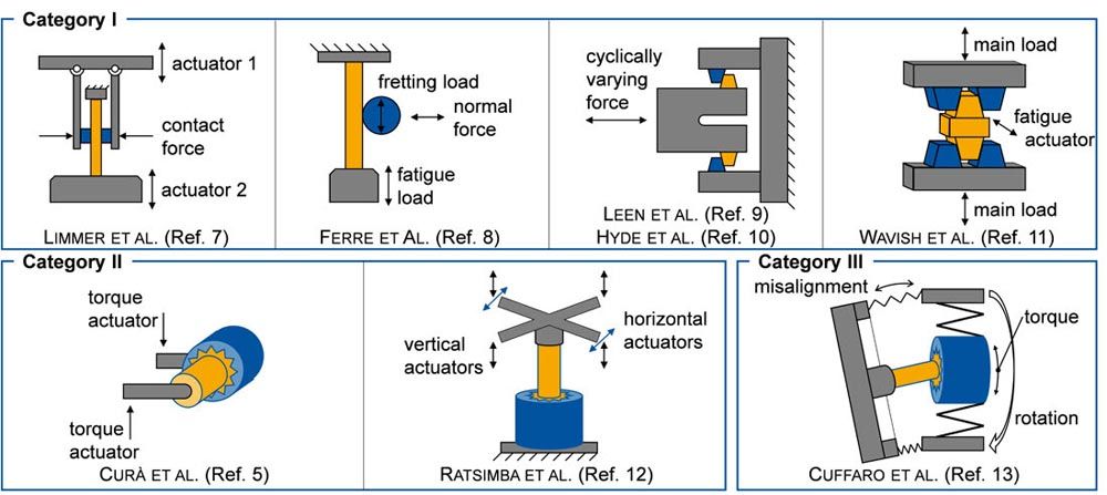

I. Analogy Tests with Simple Specimens
Limmer et al. state that the use of inline hydraulic test machines, such as linear actuators, is an efficient way to cut specimen-manufacturing costs compared to the testing of full-scale splines. Describing an assembly of a static specimen that is clamped between two fretting pads, which are moved up and down, the appearing contact conditions in running spline joints were reproduced, see Figure 1. While using a pulsating actuator for the fretting pad movement, the test time was reduced due to the possible high load frequencies (Ref. 7).
Ferre et al. additionally applied a normal load between simple-plane and cylindrical fretting pads. Combined with the load of a pulsator, that created a cyclic displacement amplitude, fretting fatigue was investigated (Ref. 8).
Also applying a normal load and a displacement amplitude, Hyde et al. and Leen et al. used representative spline specimens, with simplified tooth flanks to reproduce the frictional contact in spline joints for their fretting investigations (Refs. 9, 10).
Wavish et al. went further and combined a low-frequency in-plane cyclic normal clamping load and a higher-frequency out-of-plane cyclic fatigue stress. This enabled fretting investigations by superimposing multiaxial fretting conditions (Ref. 11).

II. Analogy Tests with Spline Joints
Curà et al. used a pulsator with a torque-generating lever device for spline-joint testing. By means of this device, component tests with variable torque amplitudes could be proceeded. Throughout the use of the Pulsator, time-efficient testing was realized (Ref. 5).
Ratsimba et al. investigated fatigue failure and fretting wear on a spline-joint test setup with multiple actuators to reproduce multiaxial loads. While testing a vertically clamped spline coupling, the torque was generated by two horizontal actuators, which were mounted on two opposing levers. Additionally, four vertical actuators in combination with a crossed lever system were mounted to the spline shaft. By means of this setup, axial loads and rotating bending forces appearing in spline joints under misaligned shaft conditions were reproduced and could be tested economically (Ref. 12).
On the one hand, analogy tests with spline joints enable resource and time-efficient testing, by using pulsating actuators and torque-generating lever devices. On the other hand, the use of these actuators instead of rotating spline joints, results in the neglection of the axial pressure peak movement associated with misaligned spline joints. Therefore, different contact patterns according to each single flank are generated. Additionally, the prevailing flow of the lubricant in the tooth mesh is not properly reproduced. Due to the missing centrifugal forces and radial conveyance effects because of the movement of the contact zone, the lubrication conditions in the analogy tests differ from real applications.

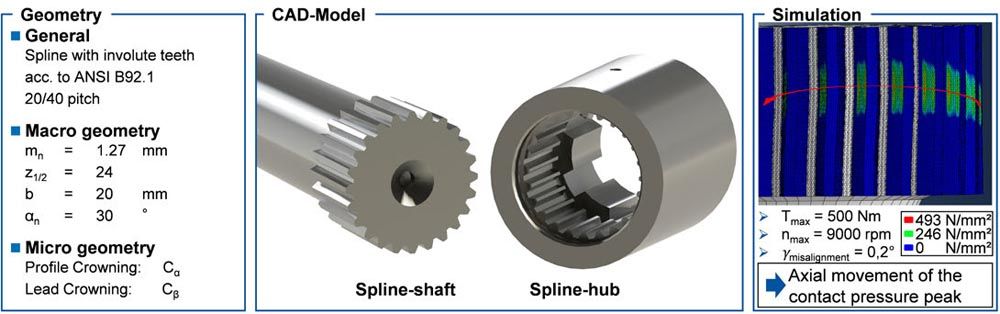

For the investigation of wear phenomena of misaligned spline joints under real working conditions with a performance characteristic of high rotational speed, medium torque, and high operating temperatures, a full-scale spline joint and a test rig were designed. The design of the test spline geometry is presented for a working, crowned, side fit spline-joint, see Figure 2. In the design process, the focus was to generate the same contact conditions, which prevail in the tooth flank contact of spline joints in aircraft-engine gas turbines. To enable testing on existing test rigs, the size of the test spline was reduced in comparison to the application. To ensure that the prevailing contact conditions resemble the contact conditions of the application, the contact pressure and the ratio of the sliding velocities were used as design parameters.
Considering the target value for the contact pressure, the spline macrogeometry was designed according to ANSI B92.1 to fit a test torque that matches the common load levels of a back-to-back test rig (Ref. 14). Additionally, the spline microgeometry and the dedicated shaft misalignment γmisalignment were designed to further fit the kinematics of the application. Therefore, a FEM simulation of the spline connection was carried out. In the operation of loaded, misaligned spline joints, the maximum pressure peaks move cyclically on each rotation axially along the tooth flanks. While analyzing the static contact zone distribution over all teeth, the displacement of the contact zone over the angular positions of the single teeth was recorded, see Figure 2. With this data and the rotational speed, the kinematics of the contact movement was calculated. The contact zone movement can be described by a cyclic sliding velocity function. For the calculation of the movement of the contact zone, not only does the rotational speed and the distance between the contact zones need to be considered, but also the sine relation of the sliding velocity function must be considered. To calculate the maximum local sliding velocity as well as the maximum global sliding velocity, the sine-dependent nonlinearity of the sliding velocity function was evaluated. Based on this calculation, the spline design was finalized to generate a tooth mesh characteristic with the dedicated contact pressure and maximum axial sliding velocity.

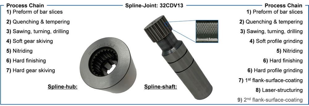

In the next step, to assess the capabilities of newly developed surface treatments, spline joints for the tests were manufactured. The designed spline geometry was processed out of the nitriding steel 32CDV13, which is widely used in aerospace applications. This material was chosen to meet the application of an aircraft-engine gas turbine. For the manufacturing, the process chain followed a conventional gear manufacturing process route for nitriding steels, see Figure 3.
Figure 3—Test-spline joint: process chain.
After quenching and tempering the preforms, the blanks were machined, followed by soft machining of the gear. Next, the specimens were plasma-nitrided and then the functional surfaces and the gears were hard-finished. For the gear manufacturing steps, a gear-skiving process was carried out for the soft- and hard-machining of the spline hubs and a discontinuous profile grinding process for the spline shafts. Then, the different surface optimizations were applied. For this purpose, the coating and structuring systems described by Stephen et al. were used (Ref. 15). Two different variants were manufactured in terms of physical vapor deposition (PVD) to generate TiN + MoS2:Ti and TiN + DLC + MoS:Ti:C multilayered coatings. Additionally, a laser structuring process took place, where dimples with diameters between dstruct = 40 to 80 µm were applied on the tooth flanks, as shown in Figure 3. Finally, a second coating step took place for selected test variants to apply a solid lubrication layer.

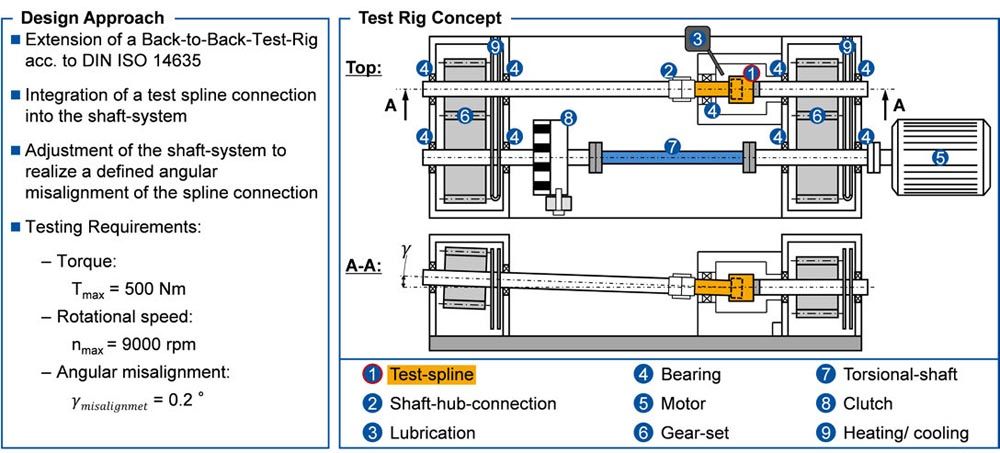

3 Test Rig Design
A common method in gear load capacity testing is to use power recirculation for the test power generation. The idea behind this approach is to apply and entrap a static torque in a power circuit through pretensioned spring elements. A motor then drives this power circuit (Ref. 16). Due to the entrapped static test torque, the motor only needs to overcome the power dissipation of the system but not the actual test power. This leads to an economical test rig design since only the power dissipation of the system must be applied during endurance testing, rather than the high power, which is transmitted by the test gears. A test rig that features a power circuit and is widely used for this testing is the back-to-back test rig, standardized by DIN ISO 14635 (Ref. 17). This test rig is built to investigate cylindrical gears. Following, the extension of a back-to-back test rig is presented, which enables the testing of spline joints, see Figure 4. Based on the test spline geometry and the targeted contact pressure and contact kinematics for spline-joint testing, the following test rig requirements were implemented:
– Test torque:Tmax = 500 Nm
– Rotational speed:nmax = 9000 rpm
– Dedicated shaft misalignment:γmisalignment = 0.2°

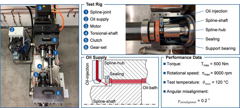

To match the performance range of the presented test spline-joint, a back-to-back test rig with a center distance of a = 112.5 mm was used. For the testing, the spline joint was integrated into the power circuit of the test rig. Therefore, the shaft system of the standard setup was reconfigured. On the motor averted side, the clutch was removed to gain space for the test spline. An axial slim clutch and the torsional shaft were applied in the shaft system on the motor side. On the motor averted side, a new bearing system was applied since the rotational speed for the testing of the spline-joints nmax = 9000 rpm exceeds the speed spectrum of the standard setup. Going further, two new shafts were designed for this side to integrate the spline joint into the power circuit. The test spline hub was directly mounted and clamped onto the right-hand side test shaft. Due to the mountability, the spline shaft was attached to the left-hand side shaft with hydraulic-shaft hub connections, which can be removed during assembly. To additionally stabilize the spline joint, a support bearing was attached to the spline shaft and the housing. The housing shields the spline joint during the test run, seals the test space against oil leakage, and enables a consistent test temperature.
To generate the dedicated spline-joint misalignment of γmisalignment = 0.2 degrees the left-hand side of the motor averted shaft system, including the spline shaft, was tilted upwards around the center of the spline joint, see Figure 4. Therefore, special bearing bushes were designed. The bearing seats of the left-hand side shaft system were aligned with the necessary deviation from the axis of the right-hand side shaft to generate the dedicated spline misalignment. To gain high precision for the manufacturing of the bearing seats, the final processing was done in a single clamping. With this procedure, the angular spline misalignment is fixed for the assembly. To change the dedicated misalignment, it is necessary to change the bearing bushes. The benefit of this design is, that the misalignment is fixed for the assembly and therefore remains the same for all tests of a test series. Going further, two cylindrical gear sets were installed, to connect the motor- and spline-shaft systems and to raise the rotational speed from the motor to the testing speed. Due to the dedicated angular misalignment of the spline shaft, the microgeometry of one gear set was specially designed for this application. Within the design, the angular misalignment is compensated for, gaining a centered contact pattern in the tooth mesh, and excluding contact pressure elevation due to edge wear.
Figure 5—Test-rig setup.
Finally, an additional oil supply was built up to provide a dedicated oil flow rate on a controlled injection temperature for the spline joint. With this extension, the spline joint can be tested under lubricated contact conditions. During operation, the oil is constantly injected into the tooth mesh. An additional sealing, which inner diameter is smaller than the pitch diameter of the spline joint creates an oil bath in the tooth contact and reduces the radial oil flow out of the tooth mesh, see Figure 5. Since the injection temperature of the oil supply is controlled, injection temperatures up to ϑmax = 120°C are realized, which enables application-related testing according to the prevailing lubrication and temperature in the spline-joint contact.

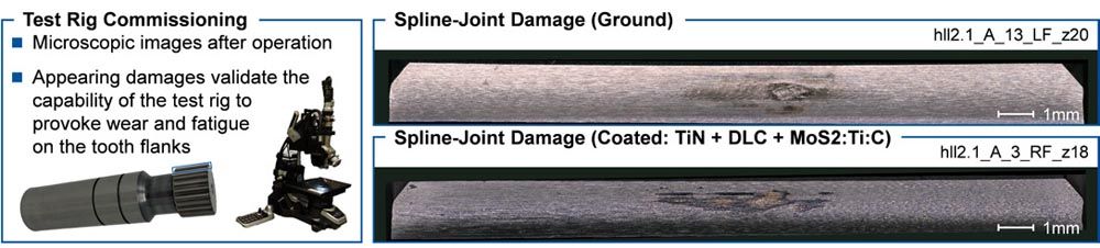

Finally, the test rig commissioning was completed with test runs. The capability of the test rig to provoke wear and fatigue phenomena on misaligned spline joints was shown by the occurrence of tooth flank damage, see Figure 7. Therefore, a first specimen with an as-ground surface finishing has been used. While analyzing the microscopic images of the run tooth flank, the contact zone showed slight changes in the appearance of its surface color. Going further, damage with material removal in the center-right of the contact zone appeared. In the second step, a coated specimen was tested to validate the capability of the test rig setup for the generation of coating wear. Since the different coating layers have different colors, the coating wear was analyzed by its appearance in microscopic images, see Figure 7. For this coating, the MoS2:Ti top layer is visible in silver. For the middle layer, a C:H:Ti layer was used, which can be seen in a black area, where the top layer was removed. Finally, the TiN bottom layer became visible in the golden areas. In the event of a total coating failure, the substrate material became visible underneath the golden layer in a gray hue.
Figure 7—Spline-joint damage.
The occurrence of tooth flank damage validated that the presented test rig in combination with the test spline-joint geometry is sufficient for the testing of wear and fatigue phenomena in misaligned spline joints. Following spline-joint testing and detailed investigations on different surface treatments and optimizations, such as coatings and laser structuring will be performed to raise the load-carrying capacity of crowned spline joints.
