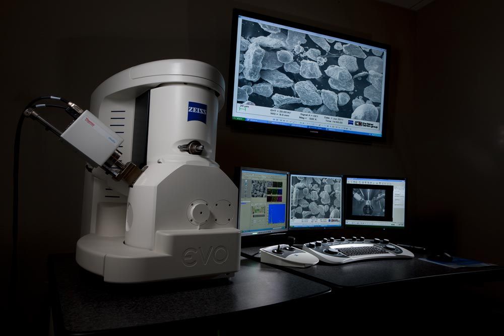

Fisher Barton uses a Zeiss scanning electron microscope to perform a very sophisticated analysis of fracture surfaces and microstructures, or a Keyence laser scanning microscope to analyze the material in 3D.

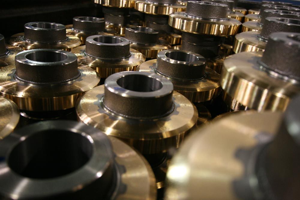

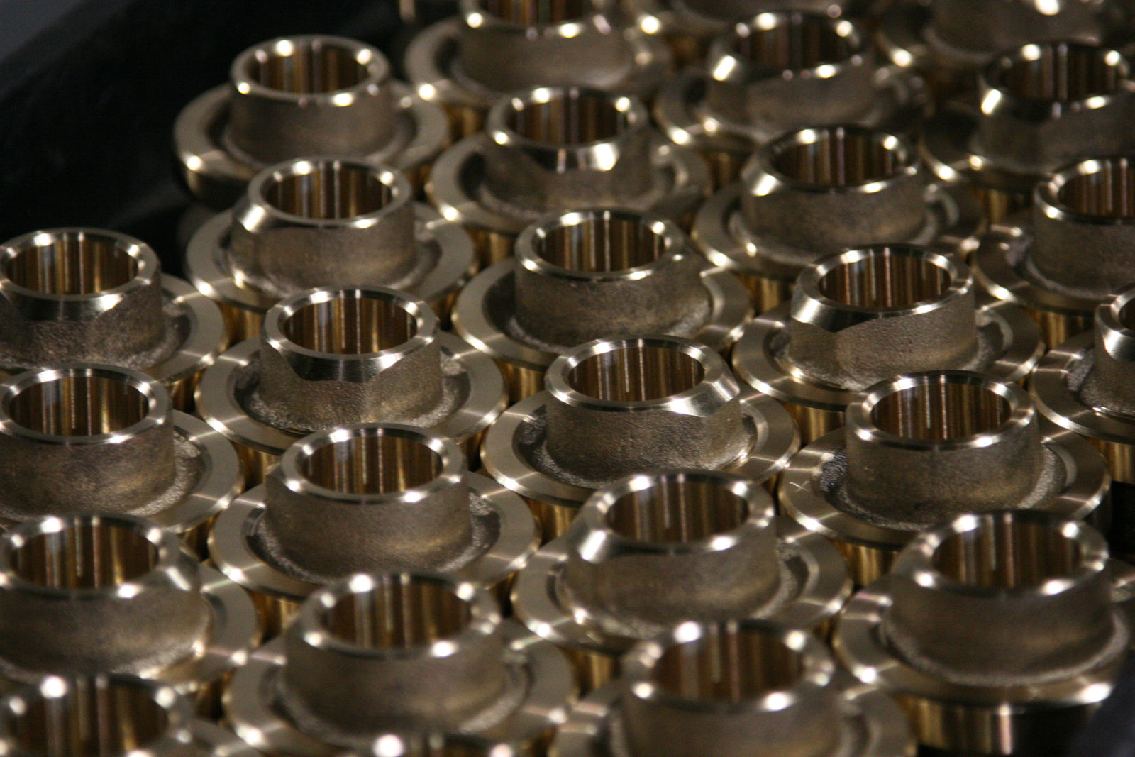

For many gear blank applications, with OD diameters from as small as 3 in. to as large as 24 in., up to 75 percent of the bronze alloy can actually be replaced through a composite solution. In most worm gear applications, the bronze rim portion is all that’s needed to achieve the desired wear results; the hub portion that mounts to the mating shaft can generally be made from a much less costly, but highly functional alternative material such as ductile or grey iron. Since the per-pound cost of bronze alloy today is five to seven times more than that of iron, cost savings can be truly significant, particularly as volumes go up.
In addition to greatly reducing material costs, this composite solution offers significant benefits versus worm gear assemblies, where a steel hub is turned from bar stock and assembled with screws to a bronze rim. This approach adds many more components to the supply chain, inventory, and time-consuming and costly machining and assembly process steps. Instead, a composite solution uses a cast iron hub with a bronze alloy rim poured around the hub. The process eliminates multiple turning, sweating and assembly process steps. This, combined with the reduction in material costs, can lead to a per piece reduction of anywhere from 10 to 30 percent on average. The savings, particularly as volumes increase, easily offsets the casting die and pattern investment. This cost is further minimized with the ability to produce these dies to the most precise dimensions and tolerances in-house.
Most importantly, the composite gear blank is considerably more robust and reliable than its assembled equivalent. This results from the cooling bronze after casting. As it solidifies, the bronze alloy rim shrinks slightly, forming a compressive mechanical bond around the iron hub. The hub also has lugs configured into the area over which the bronze rim is poured, assuring a much stronger bond than possible with screws under torque — and eliminating the possibility of assembly screws becoming loose and resulting in gear maintenance, repair, or failure downstream. Furthermore, where a keyway is required, the cast iron hub is an inherently stronger solution than the bronze alloy equivalent.
These bronze gear blanks put the strongest material at the outer edge for gear teeth that can withstand exceptionally high levels of strain, shear-stress, and overload without fracturing.
Of course, composite gear blanks are not a one-size-fits-all solution. The iron (or, in some cases, steel) hub and bronze alloy must be carefully designed so that the compressive load created by the shrinking bronze doesn’t crack the iron hub. This will vary depending on the bronze alloy used. Tin bronze, for example, works particularly well, while aluminum and manganese bronze alloys are more challenging. The provider should have a deep understanding of metallurgical properties and proprietary pre-melting and pour management techniques are critical to optimizing performance. It also beneficial if you can machine the gear blanks in-house so they arrive ready-to-hob.
