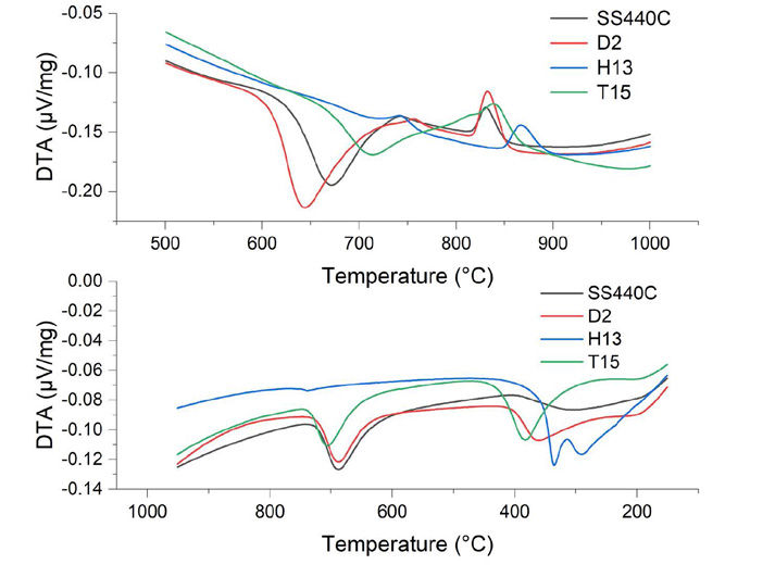

DTA during isochronal heating can record phase transformations or reactions associated with release or uptake of heat (calorimetry). Upon heating, the powders 440C, D2, and T15 undergo an exothermic reaction in the temperature range of 620-750°C, which can be attributed to (partial) decomposition of austenite, presumably via eutectoid decomposition, i.e., alloy pearlite. This transformation is most pronounced for 440C and least pronounced for T15, which correlates with the amount of retained austenite in the initial condition. A second peak, occurring between 800-900°C for all materials, is attributed to the formation of austenite (Ac1). Examination of the DTA signal (Figure 2) indicates that the austenitization start temperature for SS440C is approximately 820°C, with complete transformation at 850°C. For D2, austenitization begins around 820°C and completes at approximately 860°C. In the case of H13, austenitization starts at around 850°C and concludes at about 900°C. For T15, austenitization commences at around 810°C and is complete at approximately 875°C.
Figure 2—DTA of overspray alloy powders 440C, D2, T15 and H13 during heat and cooling with 10K/min and with an austenitization temperature of 1150°C (holding time 10 min.). Heating (top) and cooling (bottom).
The calorimetry signals from cooling at a rate of 10 K/min are given in (Figure 2). The exothermic peak for the carbon rich SS440C, D2 and T15 indicates the eutectoid transformation of austenite into alloy pearlite occurring during cooling around 750–650°C, analogous to the transformation taking place during heating. The second peak in the DTA signal (for all alloys) during cooling indicates formation of bainite at around 375°C followed by martensite formation. This behavior is consistent with CCT diagrams of the conventional wrought materials (not shown herein).

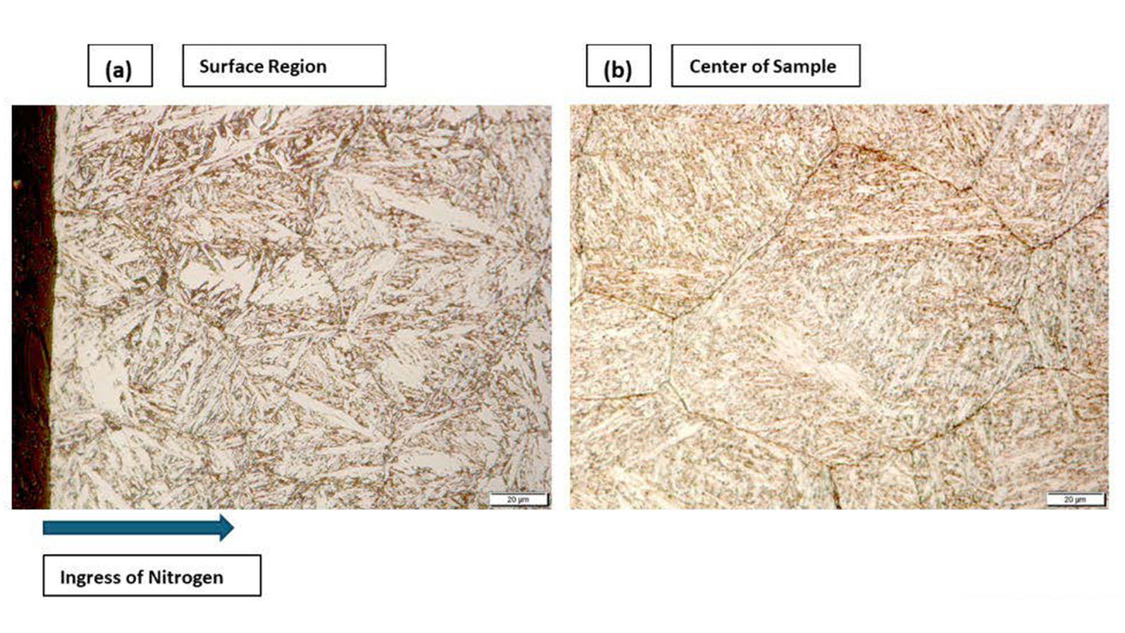

Micrographs at different magnifications were obtained from two regions of the 420 stainless steel, adjacent to the surface where the nitrogen concentration is highest and at the center of the sample. Figure 4 (a.) represents the surface region of the 420 stainless steel disk and Figure 4 (b) represents the center of the disk, which is essentially without nitrogen, but contains carbon.
Figure 4—Micrographs of AISI 420 following a 10-hour HTSN treatment at the (a) surface region of the sample, (b) center of sample.
As shown in the micrographs (Figure 4), there is a noticeable difference in the grain structure and phases within the sample. Due to the transient nature of this gaseous process, it can be inferred that there is a higher concentration of nitrogen near the surface of the sample, which was in contact with the gaseous atmosphere. In Figure 4 (a), the grain structure can be seen to be finer, albeit with larger martensitic plates. These plates can be identified by their white color. Figure 5 shows a closer view of this morphology which appears to be lenticular or thin-plate martensite and it has a characteristic zigzag pattern. This type of morphology is related to an increased nitrogen content (Refs. 21,22). It could be inferred that the dark portions indicate the presence of some form of nitride, likely chromium nitrides, which decorate the outer grain boundaries.
Figure 5—HTSN of AISI 420, Microstructure close-up at edge.
Figure 4 (b) shows much larger grains than can be seen in Figure 4 (a). This feature can be, in part, due to the absence of grain pinning in this region. Initial formation of nitrides will occur in the surface region during heating to the nitriding temperature (1,100°C); at the nitriding temperature, the nitrides will dissolve. The presence of chromium nitrides can pin grain growth near the surface where the nitrogen content is high (Ref. 21). The different composition of interstitial elements between case and core can also play a role for grain growth of the austenite. The micrograph indicates the presence of mainly lath martensite. Nitride formation should not take place, so the grain boundary decorations observed are likely carbides forming during cooling. The presence of nitrogen in this sample demonstrates an interesting relationship between solution hardening and retained austenite, where the former serves to harden the material, and the latter should soften the material when compared with martensite (Ref. 20). The higher the interstitial content in martensite, the greater the hardness. However, the higher the interstitial content dissolved in the austenite, the lower the martensitic start (Ms) temperature; therefore, more retained austenite is present. The greater the retained austenite fraction, the softer the material becomes. Here it should be mentioned that nitrogen and carbon have a significant solid solution strengthening effect in austenite; this effect is much more pronounced in stainless steels than in non-stainless steel. Another factor contributing to this balancing relationship is shifting the Ms temperature based upon the size of austenitic grains before martensitic transformation. A smaller grain size will lead to a lower Ms temperature; this effect works in conjunction with the nitrogen content. In terms of martensite morphology, higher nitrogen contents (lower Ms temperature), will result in a more plate-like morphology. Low nitrogen contents will be associated with a lath type martensite in this type of material (Ref. 23). Examining Figure 4 (b), the micrograph indicates the presence of lath martensite (Refs. 21,22) representative of a low nitrogen content.

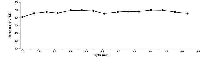

Upon measuring the hardness of the HTSN treated 420 stainless steel sample, it is apparent that the hardness is relatively unchanged over the cross-sectional distance through the sample. Figure 6 shows reasonably stable hardness readings with the average hardness measuring at approximately 673 HV. This value is in the upper range of what is achievable based upon the carbon content in the sample. There is a slight dip towards the sample’s edge which may be attributed to increased nitrogen content and higher fraction of retained austenite. Sub-zero treatment could be applied to minimize the amount of retained austenite.
Figure 6—Hardness over the cross-sectional distance of AISI 420 stainless steel after a 10-hour HTSN treatment.
When compared with the hardness of untreated 420 stainless steel, there is quite a significant hardness increase. The as-received hardness of 420 stainless steel in soft-annealed condition is approximately 200 HV. The hardness obtained from the HTSN treatment is quite similar to the hardness yielded by a traditional oil-quenched sample (approximately 610–740 HV) (Ref. 23). Using nitrogen, this maximum achievable hardness range can be extended.
