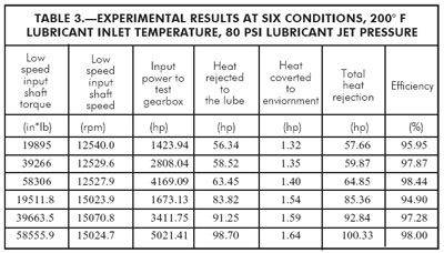

Measured Losses
The losses from the test facility are a combination of the heat transferred to the lubricant and surroundings via convection. These loss mechanisms are overcome by the power supplied to the test facility. For the conditions of interest (approximately the same conditions analyzed), the amount of drive motor power supplied as a function of load and speed is shown in Figure 9. The drive motor rotates the test and slave gearboxes and supplies the necessary power to maintain the operating conditions. For a given operation input speed, increasing load results in a linear increase in drive motor power. Increasing speed from 12,500 to 15,000 rpm input speed (16 percent increase) results in a much larger increase of operating power (30 percent increase) required.
Figure 9—Drive motor power required to rotate the entire test facility system.
The heat transferred to the lubricant is simply the product of the lubricant mass flow rate, specific heat of the lubricant, and the temperature difference across the gearbox and given by the following equation:
(8)
where:
C7 = Constant
m = Mass flow rate
Cp = Specific heat of the lubricant
ÄT = Lubricant temperature change across the gearbox
The convection losses are those due to free convection. Flat plate heat transfer coefficients were assumed for the six faces of the gearbox (Ref. 28). The surface temperature of the gearbox was measured at the mid-height and width. This temperature was assumed to exist on each face of the gearbox. The ambient temperature was assumed to be 75°F, since the system is operated in a temperature-controlled (air conditioned) test facility. These losses are given by the following equation:
(9)
where:
hi = Free convection heat transfer coefficient
Ai = Area of convection surface i
ΔT = Temperature difference between outside of case and ambient conditions
The losses measured are shown in Table 3. Table 3 shows the average of 15 readings over a 30-second period of time after the test facility had reached steady state. As shown in the table, the vast majority of the heat is absorbed in the lubricant, and the convection only makes up a very small percentage of the overall losses. The efficiency for each of the conditions is also shown in this table.
