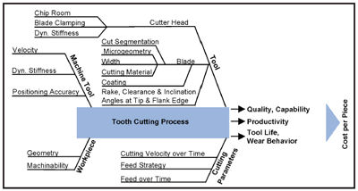

Before attempting to decrease the cost per piece in bevel gear tooth cutting, it is suggested that an analysis be made of the technological system to be optimized, in order to identify the influential factors, the cost drivers and the possible levers for achieving relevant improvements. Therefore, a number of influence factors on the most important output variables are shown and structured in an Ishikawa chart (see Fig. 2). The manufacturing system can be subdivided into the tool system, the machine tool system (including work holding device), the workpiece and the cutting parameters.
Figure 2—System analysis of bevel gear tooth cutting technology.
The high number of influential factors, their interdependencies with regard to the output variables, and the intransparencies (areas where we lack knowledge) about all of the effects and correlations make the manufacturing system highly complex, according to Wöhe’s definition (Ref. 14). Thus total understanding is nearly impossible. Despite this, the investigations can improve production, since selected parameters have been subjected to planned variations and full-factorial designs while other parameters (e.g. machine tool, workholding devices, workpiece, tool material and batch) have been kept constant to achieve a good signal-to-noise (S/N) ratio in laboratory trials.

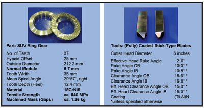

The presented findings were obtained by manufacturing a face-milling designed SUV ring gear, as shown in Figure 4. All blanks were manufactured in the same batch.
Figure 4—Trial workpiece and tool data.
In most trials, fully coated carbide blades have been applied as specified in Figure 4.
