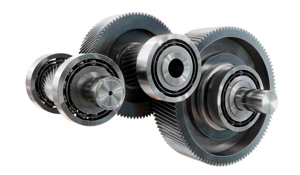

Eaton boasts 100+ years of experience that began in 1911 when Joseph Eaton invented the first gear-driven truck axle. Fast forward to 2023 and the company has pushed all its chips across the table to leverage its gear manufacturing and transmission expertise into the electrification movement.
“We’re updating everything from forging to the finishing of gears,” said Justin Hopkins, product director at Eaton. “EVs require additional technology for finishing operations so we’re developing new toolsets, getting more involved in skiving operations and making strategic investments that will better prepare the organization for this incredible shift taking place in passenger and commercial vehicles.”

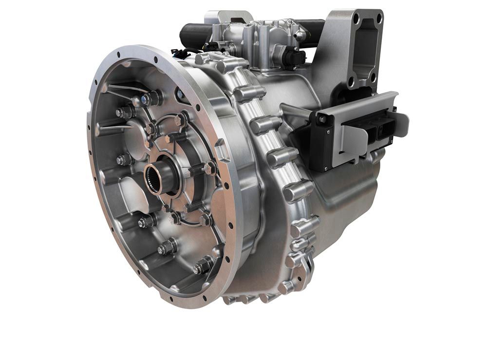

“We’re looking at getting more range out of these EVs—lightweight factors come into play,” Hopkins added. “All the OEMs don’t want to know the gearbox is there. It also must be bulletproof. It must be 99 percent efficient, hyper quiet and needs to be cost-effective.”
The list of demands seems to increase daily, but that’s not stopping these engineers from rolling up their sleeves and working on the best possible solutions. In addition, they will continue to monitor the changing trends taking place in the passenger as well as commercial vehicle markets. It’s clearly a fascinating time for the automotive industry and the entire transportation market segment.
“Tesla uses a 1-speed automatic transmission that utilizes a single gear,” Kramer said. “When and where does the market shift to multi-speed transmissions and what is that going to look like? Eaton offers 4-speed transmissions as well as fixed reduction gear sets, so we’re trying to develop technology in both spaces.”
“On the commercial side, OEMs are currently experimenting with a lot of different architectures,” Hopkins said. “We’re selling integrated EV technologies, but we need to be prepared for the move toward smaller packaging, lighter materials, etc., so we can be ready regardless of the architecture selection.”
