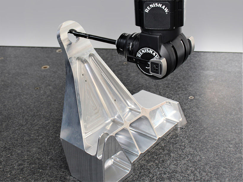

Verisurf Software, Inc. announces a surface finish measurement probe and reporting solution for CNC CMMs equipped with Renishaw REVO SFP2 (Surface Finish Probe).
The surface finish measurement feature is included in the soon-to-be-released Verisurf 2024. Using direct output from the Renishaw REVO SFP2 probe, Verisurf CMM programming can include defined surface finish/roughness evaluation from 6.3 μm to 0.05 μm (250 μin to 2 μin) Ra with results added to automated quality reporting.  This is made possible by Verisurf support for Renishaw REVO multi-sensor 5-axis measurement system. Surface finish measurement is fully integrated with the standard Verisurf CMM inspection program and includes automatic changing of probes, based on the inspection plan, which eliminates CMM downtime, and maximizes inspection throughput.
The REVO SFP2 works on a variety of surfaces including bores as small as 5mm (.196”) using a 2, 5, or 10-micron radius diamond stylus tip, and can output Ra, RMS, and raw data for further analysis and reporting. When combined with Verisurf the solution provides detailed and accurate data that can be verified against a nominal 3D CAD model, enabling operators to make informed decisions regarding component quality and acceptability.
Verisurf operates Renishaw-equipped CNC CMMs through the Verisurf Device Interface (VDI), which supports two-way communications with virtually all sensor types and brands.  The VDI sends programmed instructions to operate the CMM and collects measurement data for analysis and processing.
