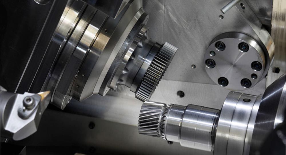

First in the production chain is the Pittler V300, an innovative multi-technological production solution that combines fully automatic turning, milling, and drilling operations as well as gear cutting using the highly productive skiving process. This enables complete soft machining of the hollow shafts in just two setups on one machine. It reduces setup, transport, and idle times, which means that the total processing time is also shorter. In addition, processing on just one machine means lower investment costs and a shorter time-to-production.
Skiving is used to produce gears in green machining. This is a metal-cutting process used in the production of gears which is based on a patent filed by Wilhelm von Pittler in 1910. Thanks to the latest developments in manufacturing technology, skiving has emerged as an efficient and flexible alternative over recent years for the gearing of components.
One of the characteristics of skiving is the oblique arrangement of the tool axis to the workpiece axis (Figure 3). This is called an axis intersection angle. This positioning of the tool, a defined axial feed, and the coupled speed of the tool and workpiece results in a relative movement. This relative movement “peels” the tooth gap out of the workpiece along the main cutting direction.
gt0723_Page_27_Image_0004.jpgFigure 3—Skiving with running gear on an e-shaft. (Source: Pittler T&S)
The contact kinematics of skiving require a tapered tool when the cutting point is on the direct line connecting the tool and workpiece axis. To avoid this, the DVS Group has further developed the power-skiving process: The cutting position is shifted in the Y direction out of the direct line connecting the tool and workpiece axis. This optimization enables the use of cylindrical tools with a substantial increase in tool life through frequent regrinding of the tools. Accordingly, the cost of tools is reduced significantly.
gt0723_Page_28_Image_0002.jpgFigure 4—Animation of the skiving process. (Source: Pittler T&S)
The quickly changing cutting forces of the skiving process cause vibration in the machine and the control system. That is why skiving requires extremely rigid machine structures, tool and workpiece carriers as well as highly optimized control circuits. This is precisely what the Power Skiving machine concepts from DVS were designed for.

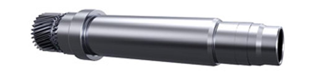

The heat treatment of the shaft is followed by the first hard-fine machining step. Most rotor shafts have a similar design due to the required properties. A typical monobloc e-shaft consists of a running gear or spline, two bearing seats, two sealing surfaces, and a rotor seat. Depending on how the laminated core is fixed, the rotor seat is additionally provided with notches or spanner flats.
Figure 10—Machined rotor shaft with running gear, bearing seat, sealing surface, and rotor seat. (Source: DVS Technology Group)

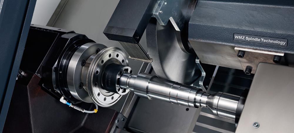

The bearing seats and sealing surfaces are machined by plunge grinding (Figure 11) and the rotor seat by peel grinding or plunge grinding (Figure 12). End-faces and cut-ins are usually machined by hard turning during the same clamping, as a rotary turret can be integrated into the Buderus 235VH/M if required.
gt0723_Page_30_Image_0001.jpgFigure 11—Grinding in single clamping. (Source: BUDERUS Schleiftechnik)
 gt0723_Page_30_Image_0002.jpgFigure 12—Grinding in single clamping with WMZ Spindle Technology. (Source: BUDERUS Schleiftechnik)
Tolerances in the micrometer range should be achieved on the bearing seats, sealing surfaces, and rotor seats. Experience has shown that typical tolerance requirements range between 0.004–0.03mm for cylindricity, 0.002–0.025 mm for roundness, 0.005–0.08 mm for coaxiality, and 0.008–0.1mm for concentricity. For sealing surfaces and rotor seats, it is also necessary to obtain a peak-to-valley height of up to 1 µm.
This accuracy is possible by grinding with the Buderus 235VH/M in a single clamping.
