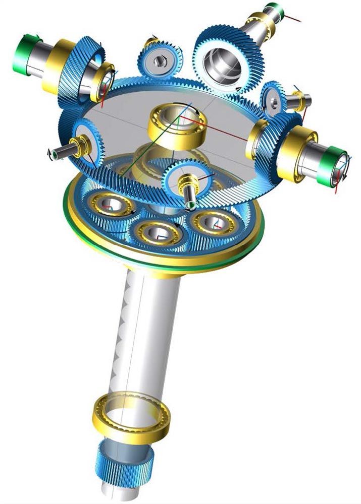

In the case of straight bevel gears, spiral bevel gears, and hypoid gears the same rules apply with some additions. Spiral bevel gears have many applications as speed increasers. One example is the helicopter main rotor drive in Figure 1. The ring gear is driven by two pinions, that are connected to a first-stage reduction which is actuated by two jet engines. The additional pinions have a power take-off function and operate the tail rotor, oil pumps, an air compressor, and an electrical generator. These power take-off pinions have ratios of 4 to 6 with the central ring gear which makes them speed increasers (Refs. 2, 3).
Figure 1—Helicopter main rotor drive.
This article appeared in the July 2024 issue.
Another prominent example of a speed increaser is the power take-off transfer case of an SUV, shown in Figure 2 (Ref. 4). The specific SUV has an east-west engine orientation and requires a 90-degree speed-increasing transmission to actuate the propellor shaft to the rear axle. At the rear axle, there is a second hypoid gearset required to drive the rear wheels, but this rear hypoid gearset is a speed reducer.
Figure 2—Power take-off transmission of an all-wheel drive SUV.
The examples in Figures 1 & 2 show that it is common to use bevel and hypoid gear speed increasers. The following sections will explain the differences between speed-increasing and speed-reducing bevel gear transmissions.

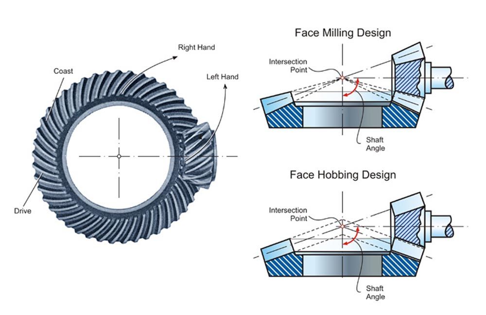

Design Parameters—Spiral Angle, Profile Shift
A typical spiral bevel gearset with a ratio of 13:45 and a right-hand gear meshing with a left-hand pinion is shown in Figure 3. In case of a speed increaser, the gear rotates in a counterclockwise direction, such that it drives the pinion on the drive side. The drive side is defined as the convex gear flank, meshing with the concave pinion flank. The contact force is shown in Figure 6 related to the gear member. The force Fz presses the gear in an axial direction away from the pinion and the force Fy presses the gear away from the pinion in the lateral direction. This is the preferred condition that allows the lubrication oil to enter the contacting zone and separate the two “contacting” flank surfaces. In the case of the opposite gear driving direction (clockwise), the contact of the pinion and gear flank is on the coast side which creates the opposite force directions and attracts the gear towards the pinion. This will reduce or eliminate the backlash which leads to an interruption of the lubrication film, followed by scuffing on the flank surfaces in the area of high sliding velocities. These are the areas with the largest distance to the pitch line (Ref. 5).
Figure 3—Spiral bevel gearset definitions.
If the main driving direction is a clockwise gear rotation (relative to Figure 3), then the hand of the spiral has to be changed to a left-hand gear and a right-hand pinion. In the case of a bidirectional speed increaser, the effects of the coast side have to be reduced. This can be accomplished by reducing the spiral angle and by increasing the cutter diameter. Against the standard recommendation of a 35-degree spiral angle, a 20-degree spiral angle should be used for bidirectional operation in a speed-increaser. The involute outer cone ratio, shown in the dimension sheet of every spiral bevel gearset, should not be used as a guide for selecting the optimal cutter diameter for bidirectional speed-increasers. The cutter diameter should be selected close to the mean ring gear diameter.
Also, for unidirectional speed increasers, the spiral angle should not exceed 27 degrees to keep the additional contact and bearing forces low and to guarantee good hydrodynamic lubrication. The circumferential speed of 60 m/sec is possible if the gears are ground and if good lubrication is provided.
Profile shift might be necessary for the ratio shown in Figure 3 to avoid undercut and achieve a large active working profile. For speed increasers with a ratio greater than 3, the root transition of both the driving gear and the driven pinion are prone to scuffing. To keep the sliding velocities low, close to the transition to the root area, the profile shift of pinion and gear should be zero or very low. This translates to an addendum modification factor which results in a pinion and gear dedendum (listed in the dimension sheet) which is about 50 percent of the working depth.
