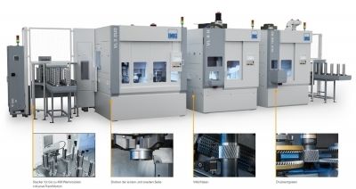

By just looking at the machines in the Modular Solutions series, there is nothing that gives away that these are machine tools using a wide variety of technologies – except for the type designation. The machines themselves pretty much all look the same.
“The mechanical design is optimized to facilitate the interlinking of several machines. The gaps between machines, the transfer height, the placement of energy containers and chip conveyors – all that is standardized to enable the efficient construction of complex production lines based on a modular approach,” Loetzner said.
At EMAG, Modular Solutions means a multi-technology machine concept on a unified basic platform. All the machines in the EMAG Modular Solutions series have the same machine base made out of Mineralit polymer concrete– essentially a chassis on which the rest of the machine is installed. Every machine of this type also comes with EMAG’s signature pick-up automation system. This means that each machine has an integrated parts storage unit for blanks and finished parts.  A pick-up spindle automatically loads and unloads the machine. For machining the workpieces, the EMAG Group’s entire range of technologies is available. For turning operations, the machines are equipped with powerful working spindles and EMAG’s proprietary turret with twelve tool posts. The latter can also be fitted with driven tools for drilling and milling.
Gears are made using technologies from EMAG. To complement the hobbing processes, a variety of methods for chamfering and deburring are available, depending on the requirements of the part. For hard machining, inside and outside grinding are available as well as technologies and tools for hard turning and scroll-free turning.
“This diversity of technologies on a unified machine base, combined with EMAG’s proprietary TrackMotion automation system, is our idea of production systems for Industry 4.0,” Loetzner said.
TrackMotion – Complete Automation
The TrackMotion automation system is the logical continuation of the concept behind Modular Solutions. Like the machines, the automation system is designed to be completely modular and can be adapted optimally to any production project. “To achieve the best symbiosis of automation and machine tool, we designed our machines so that the automation system can traverse directly behind the machining area. We basically built the machines with a tunnel for the TransLift to operate in. This really sets our Modular Solutions apart from the competition,” Loetzner said.
The TransLift is an NC gripper that moves on a rail system through the tunnel mentioned above. The gripper transfers workpieces between the parts storage unit and then machines and flips the part over between operations.
“The automation system is also easy to scale by simply extending the rail for additional TransLifts to run on. The system is simple but ingenious,” he added. “One thing that makes the overall system so interesting for Industry 4.0 is its focus on the single part. Instead of keeping dozens of workpieces in various stages of completion somewhere on a conveyor between or behind the machines, separate transport makes each part trackable without requiring special marking.”
