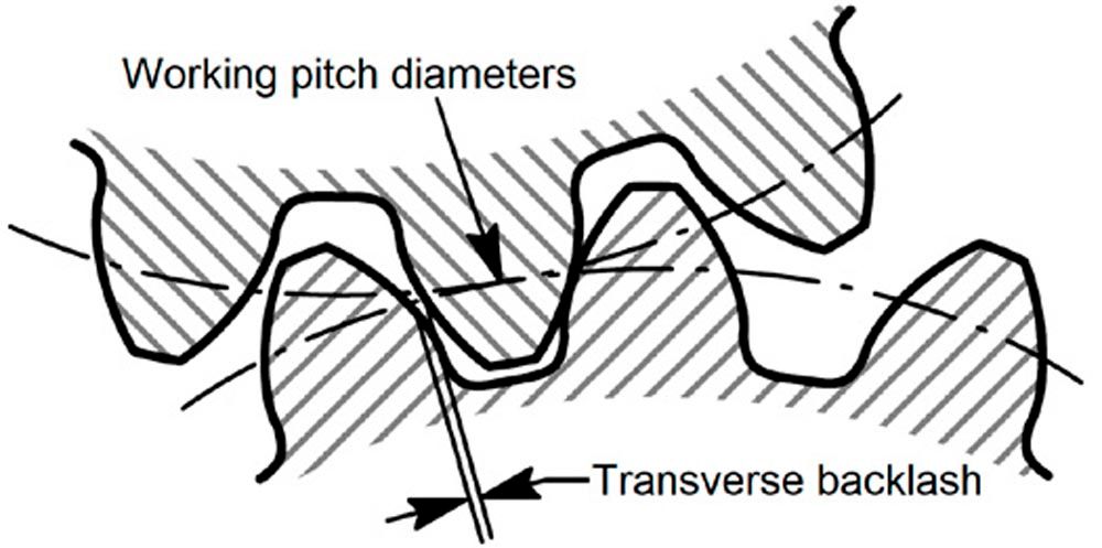

Gear backlash refers to the clearance, or play, between the teeth of gears in a mechanical transmission system, as shown in Figure 1. Gear designers have strived to minimize gearing systems’ backlash due to the impact on precision, efficiency, noise, vibrations, wear, motion control, system complexity, and safety. Their significance varies depending on the applications, but designers need to carefully consider these factors when developing robotics systems to ensure they meet the desired performance and safety standards.
Figure 1—Gear backlash.

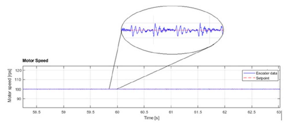

Backlash can contribute to oscillations and vibrations in the robotic system, especially when the robot changes direction or stops and starts suddenly. These vibrations can affect the overall stability of the system and its ability to handle delicate tasks, as demonstrated in 2022 by Giovannitti (Ref. 2) in the Journal of Intelligent Manufacturing 2022 and shown in Figure 2, below.
gt0324_Page_18_Image_0001.jpgFigure 2—Noise and vibration due to gear backlash.

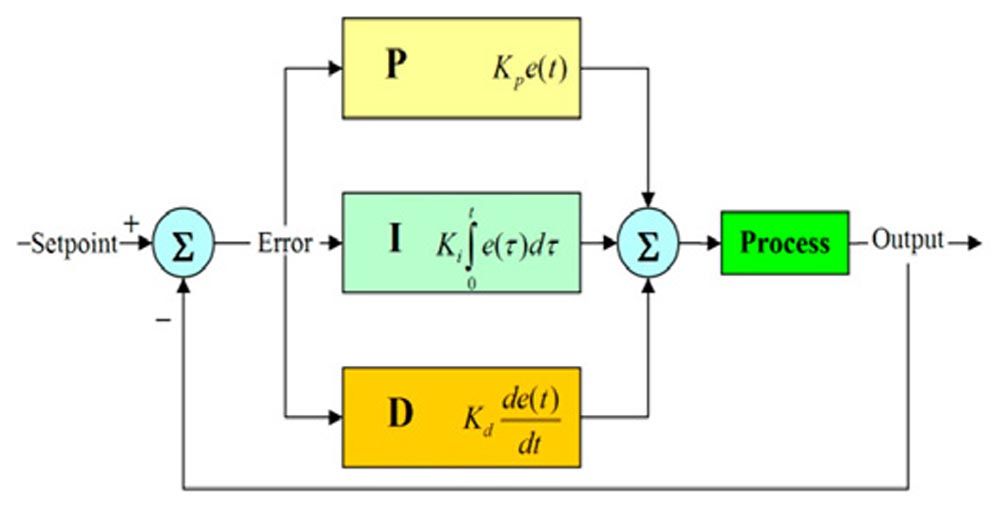

Figure 3—Basic PID control block diagram.
Depending on the direction of movement, the gear backlash may result in a different load position on the output side, causing delays and oscillations at the start or stop of the movement. The first solution that comes to mind is to mount a second encoder on the gear output shaft and base the control on a double feedback loop, increasing the complexity and error compensation. The controller first closes the inner loop, which is the velocity control loop, and then a second load position loop. See Figure 4 (Ref. 3). The velocity control loop receives feedback from the motor encoder, and this feedback determines the appropriate velocity feedback gain, which imparts a damping effect on the system to reduce oscillations.
