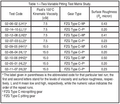

Gears tested. Both the FZG Type PT-C pitting gears and the Type GF-C micropitting gears tested were designed and made by ZF Friedrichshafen AG (Refs. 12–13). The supplier indicated that both types of gears were made from the same steel material and hardened by the same process. They had the same tooth profile geometry, pitch-line diameter, addendum and dedendum depths. However, the pinion and wheel gears of the same batch are usually not made from the same single melt, but they are hardened by the same process and at the same time. This could also be true for pinion gears that are provided from the same batch of gears.
The difference in surface roughness between the Type PT-C and GF-C gears was achieved by specially dressing the grinding wheels and the control of the surface roughness during grinding. The specification for the gears requires the surface hardness to be HRC 62 (Refs. 12–13); we did not independently verify the value.
In this study, before each pitting test was carried out, the surface roughness of the gear was measured by a one-dimensional profilometer. For the matched pinion/wheel set, three teeth of a pinion were chosen to measure the surface roughness of the contact side by profilometry along the center involute of each tooth profile. This was repeated for the gear. The arithmetic mean value of the six measurements was taken as the Ra value of the pair. The procedure for the measurements was described as part of the test procedure (Refs. 14–15). The surface roughness values of the pinion/wheel sets are shown in Table 1.
Oils. Two oils of different viscosities were prepared with the same additive package, which was developed for application in automatic transmissions. Even though both oils use polyalphaolefin (PAO) as the base oil, different combinations of PAOs were necessary to prepare the two oils at two 100°C kinematic viscosity levels—7.5 cSt and 15 cSt. The oils are shown in Table 1. The boundary frictional properties, film formation properties and anti-corrosion properties of the test oils were measured as described previously (Ref. 3).
Pitting test matrix. The two variables investigated in this study were the gear surface roughness and oil viscosity. Thus, a matrix of four different pitting tests was carried out. Each test was carried out twice.

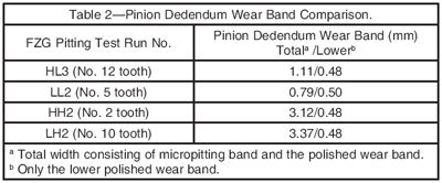

Overall, the micropitting band width appears to depend only on the type of gear used. The oil viscosity practically has no effect on the micropitting band width. However, all four sets of SEM images appear to have a common, polished wear band of approximately constant band width, which is shown between the lower two arrows. Table 2 summarizes the observations obtained from the SEM images shown in these four figures.
It is particularly interesting to compare the two sets of SEM images between Figures 1 and 3. The difference between the two SEM figures is that the former was obtained from a run that used an FZG Type PT-C pitting gear while the latter was taken from a run that used an FZG Type GF-C micropitting gear. Both runs used the same high viscosity oil; yet the impact on the micropitting band is quite dramatic. The run with the pitting gear had a fatigue pitting life of 42 hours, while the one with the micropitting gear had a fatigue pitting life of 170 hours.
Nevertheless, the micropitting gear accumulated a total micropitting area of 448 mm2 in just 26 hours while the pitting gear accumulated a total micropitting area of only around 224 mm2 by the time the test reached 42 hours. Similar results can be found comparing Figures 2 and 4. This time, the comparison is between two runs using the same low viscosity oil but different types of gears.

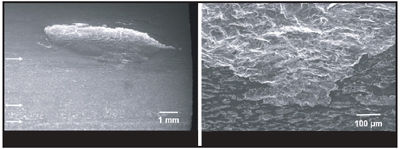

Tooth cross sections. Figures 6 and 7 show cross sections of pitting and micropitting gears of the HL3 and HH2 runs, respectively. Figure 6 shows the cross section of a pit and the associated cracks for the HL3 pitting pinion gear with the pit initiated below the pitch diameter and continuing past the pitch diameter and into the region where the traction changes its direction. Figure 7 shows the cross section of a pit and subsurface cracks for the HH2 micropitting pinion. The starting point for the initiation of the pit in the micropitting gear is quite different from that in the pitting gear. For the micropitting pinion, the starting point for the initiation of a pit is just below the pitch diameter, with the majority of the pit lying above the pitch diameter.
Figure 6—SEM image of a cross section through a spall on the 9th tooth of the HL3 run. This test involves a 15 cSt oil and a pitting gear.

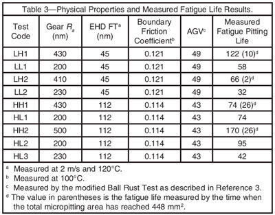

Fatigue pitting lives. The measured fatigue pitting lives obtained from the FZG pitting tests of the matrix described in Table 1 are shown in Table 3. For the runs using the micropitting gears, both values of the fatigue pitting life determined by the two different methods are listed. Table 3 also shows the EHD film thickness, boundary friction coefficients and anti-corrosion properties of the two oils used in the matrix study.
To quantify the effect of the EHD film formation, friction reduction and anti-corrosion properties of oils on the fatigue pitting life in the 120°C FZG pitting test, the physical properties of the two oils were correlated to the fatigue pitting lives obtained from the matrix study. Using multiple linear regressions with standard statistical techniques (Ref. 16), a model similar to the previous study (Ref. 3) has the following general form:
Fatigue pitting life = A + B * EHD FT + C * BndFr + D * AGV + E * Ra
(1)
The final model for fatigue life contains only those terms with a statistical significance greater than 90 percent. After the values of the constants A, B, C, D, and E are known, the relative effects of the EHD film thickness (EHD FT), boundary friction (Bnd Fr), anti-corrosion properties (AGV) and surface roughness (Ra) on the FZG rig test results are determined.
Below is the model obtained using the fatigue pitting lives determined by the conventional procedure, which measures the time when the total pitting area reaches 5 mm2.
Hours to pitting = -15.8 + 0.46 * EHD FT + 203.8 * Ra

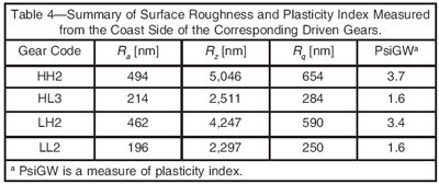

The Ra values in Table 4 closely agree with those shown in Table 1. This gives us confidence that surface roughness and plasticity index measurements from the coast side of the driven gears are reasonably reliable. This means that the plasticity index of the micropitting gears is larger than that of the pitting gears by a factor of greater than two. However, the measured plasticity indices are larger than theoretically expected from the definition given by Greenwood and Williamson (Ref. 18), since plasticity index is proportional to the square root of Ra or Rq and inversely proportional to the square root of summit radius of the asperity, ß. Ra is the arithmetic mean of the gear tooth surfaces while Rq is the corresponding geometric mean value.
Nevertheless, plasticity indices of the micropitting gears are significantly larger than those of the pitting gears. Micropitting gears with a plasticity index at least twice as large as the pitting gears can more readily undergo micropitting wear resulting in greater gear tooth profile geometry modification and providing some stress relief.
