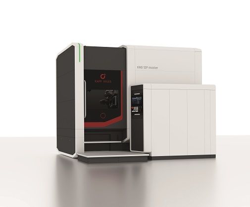

KNG 12P Master
The machines in the master series are perfect for high-precision machining of external and internal gears as well as special profiles.
The machine concept stands for maximum workpiece quality. High thermal stability and rigidity are achieved through an optimized design and matching components. The inherently rigid machine base enables easy installation without anchoring in the hall floor. The dressing and grinding spindles are equipped with state-of-the-art direct drives.
The new functional and ergonomic machine design paired with an innovative user-friendly interface supports the user during set-up and optimization of grinding projects. High-performance technology options and application-specific alignment and measuring devices mean that maximum quality can be achieved even with batch size 1.
