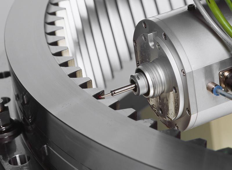

image3.jpgFigure 3 On-board inspection of both internal and external gears is fully integrated on Gleason machines.

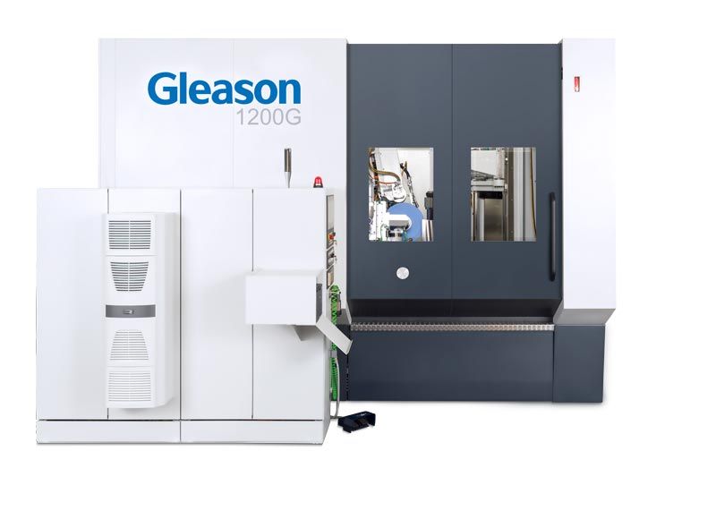

In the 1200 mm size, Gleason offers two machine models. The new 1200G is a highly flexible and universal machine that is intended to suit most grinding needs, particularly the demands of the wind market, and it covers a wide range of applications with one grinding wheel. It is a compact, one-piece machine bed for increased rigidity and stiffness, and it can be outfitted with one of three different internal or external grinding-head options. It also supports worm-grinding options.
Image4.jpgFigure 4 The new Gleason 1200G profile grinding machine.

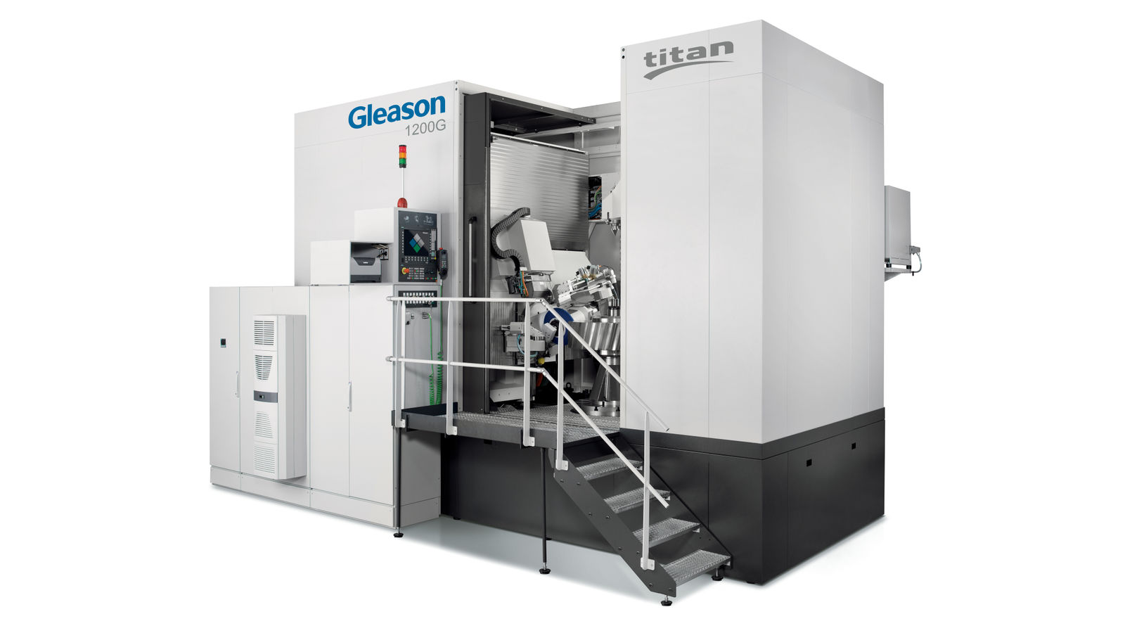

The other 1200 mm option is the high-performance Titan 1200G from the Titan series which has a tool changer — a feature that remains unique to the industry — for excellent surface roughness, higher productivity, and quality by using separate grinding wheels with optimized grit sizes for roughing and finishing. The machine can also be utilized to grind two different gear profiles on a single workpiece, such as a spindle with timed gears on each end, which is ideal for this machine, because it doesn’t require separate setups.
 titan-1200g_machine_15680-1_20120307.jpgFigure 5 Gleason’s Titan 1200G has a tool changer that allows greater versatility.

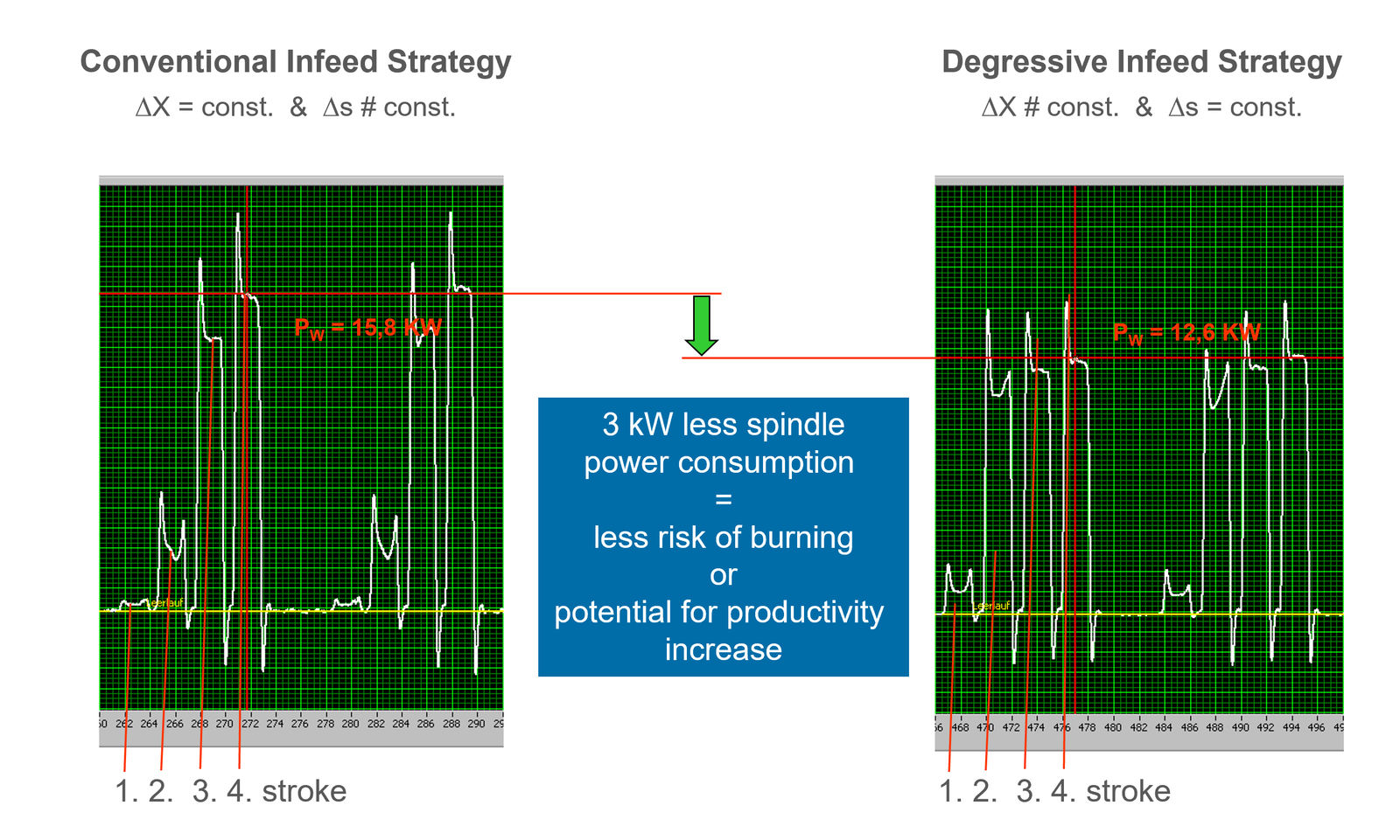

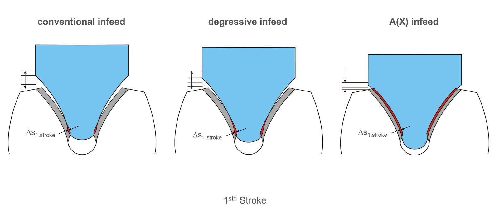

Typically a machine is set up with a grinding wheel of a particular grit size, and while the dressing parameters can be adjusted to achieve different finishes from the same grinding wheel — say one for roughing and another for finishing — the finish will only be as good as its actual grit size, meaning it will not be up to the level of superfinishing allowed by switching over to a separate tool with a finer grit size. Hence, when there is only one tool to work with, the grit size is always prone to compromise with its dual task of material removal in the roughing strokes and surface finishing in the final strokes.
IMAGE 7-P66 - Stock Specific grinding.pngFigure 7 Stock-specific grinding eliminates the potential for empty grinding strokes.
IMAGE 8-Infeed Strategies.pngFigure 8 Infeed strategies with distributed material removal per stroke improves productivity and process reliability.
IMAGE 9-Spindel Power Comparison.pngFigure 9 Graph demonstrates the spindle power comparison between infeed strategies.
The temptation in grinding is to speed up the production time by adjusting the speeds and feeds of the machines, but this will invariably affect part quality and tool life, which will ultimately lead back to waste of both time, money, and other resources in the form of bad gears, energy, and undue machine wear. Stock-specific grinding eliminates any potential empty grinding strokes by using a touch probe to evaluate the orientation of the gear in relation to the grinding wheel in the event of distortion from heat treatment. The algorithm determines the high and low points from a representative sample of measurements. It averages them based on the typical ovaloid distortion of a large gear being hung in an oven for hardening. The machine will only rough pass those high teeth profiles skipping teeth that are already within range until in subsequent passes more teeth are ground until all have been brought to their finished pass dimension.
The main task of dressing is to generate the correct wheel geometry, sharpen the wheel topography, and establish a minimum runout of the wheel. The three primary dressing methods are base dressing to create a new wheel geometry, rough dressing for material removal, and finish dressing for quality surface finish and precision. The wheel can be dressed to have a more aggressive microgeometry for roughing strokes, and a finer one for finishing strokes. Smart dressing utilizes the base strokes to establish geometry by utilizing more of the dressing wheel tool surface area than just one edge, which can be preserved for dressing the grinding wheel for roughing and finishing.
With a conventional infeed strategy, a gradual amount of stock per flank is ground and hence the real material removal is increasing from stroke to stroke, but that means most of the material is removed in the last roughing stroke, which creates a high risk for thermal damage in the last stroke and greater power consumption on the grinding spindle. An infeed strategy with a distributed material removal per stroke improves productivity and process reliability. Degressive infeed means taking a more aggressive first stroke and then less with subsequent strokes hence degressive, and an A(x) infeed strategy means a slight tilt on the A-axis for the x-axis infeed ensures contact with the whole tooth profile, which means less infeed required hence fewer strokes and increasing productivity.
