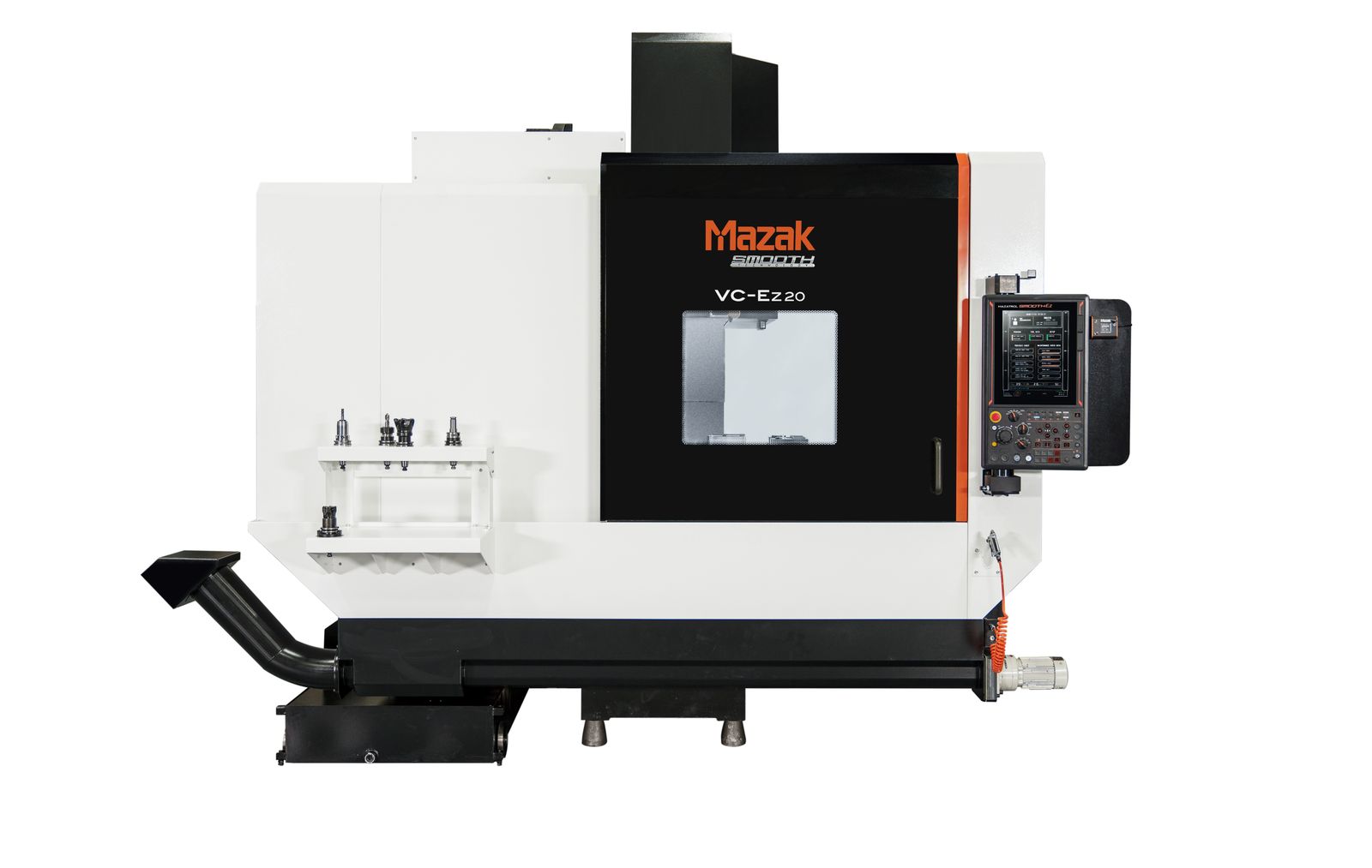

For vertical machining, Mazak’s VC-Ez 20’s rugged 40-taper spindle and space-saving design offer unprecedented performance and affordability with a full range of spindle, auto tool changer and chip/coolant management options. The cost-effective, highly configurable machine meets many production facility needs with a compact, space-saving design.
Enhanced operator ergonomics and a generous work area ease the loading and unloading of workpieces and tools, while an extremely fast rapid traverse rate of 1,654 ipm (42 m/min) in the X, Y and Z axes enables higher throughput. A 25 hp (18.64 kW) 12,000 rpm (standard) or versatile 29.5 hp (22 kW) 15,000 rpm (optional) spindle offers 81.13 ft-lb (110 Nm) of torque for additional production versatility.
All VC-Ez Series machines sport C-frame designs with X and Y axis motion via moving the table and saddle. For rigidity and repeatable part precision, guideway systems use Mazak’s Hybrid MX linear roller guide systems, and dual lagged pre-tensioned ball screws ensure precise axis movement.  For increased maintenance free operation, the auger-type chip removal systems provide an economical solution, or for increased chip volume the addition of an affordable hinge-type chip conveyor ships affixed to the machine to eliminate the cost of a second shipping pallet.
