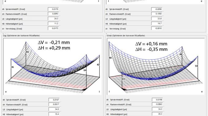

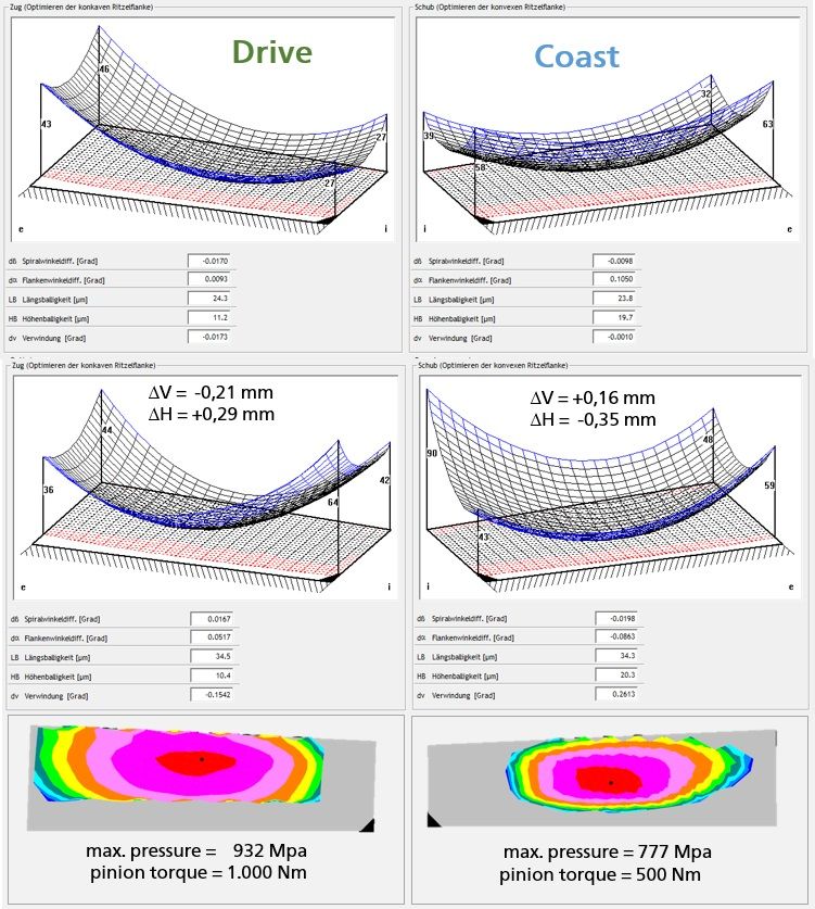

Figure 2: Ease-Off, displacements and loaded contact patterns.
Figure 2 shows the Ease-Off and the displacements resulting from the torque with the associated resulting load bearing diagrams. The load-induced displacements of the pinion are ΔV= -0.2 mm and ΔH= +0.29 mm at 1,000 Nm on the drive side. Due to the lower axial rigidity of the axial drive in negative ΔH direction, the calculated displacements of the pinion at 500 Nm for the coast side are ΔV= +0.16 mm and  ΔH= -0.35 mm.

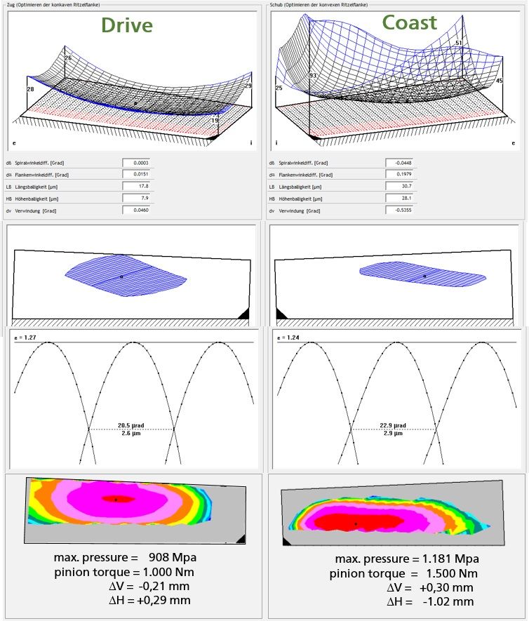

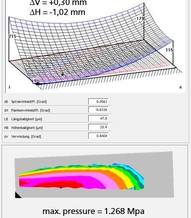

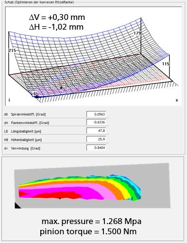

The 500 Nm load for the coast side is still non-critical. But when recuperating with high braking power, substantially higher torques occur. With a braking power of 250 kW and a speed of 70 km/h, the resulting torque at the pinion for our example is 1,500 Nm. For this gearbox design, the displacements are ΔV = +0.3 mm and ΔH = 1.02 mm. Here we have our critical case. The backlash will significantly decrease, and an equal effect happens to the tip-root clearance. In a worst case scenario, this could result in jamming of the gear. In order to avoid this, we need to increase the backlash considerably and also increase the tooth root factor in the dimensions of the gear.
It can be seen immediately in Figure 3 that the loaded contact pattern for the coast side is a distinct edge contact with a maximum pressure of nearly 1,300 MPa near the heel in the root. The shape of the tooth flank is obviously not suitable for ensuring a reasonable tooth contact for the high load and associated displacement.
Figure 3: Loaded contact pattern at 1,500 Nm torque.

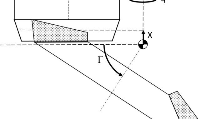

Figure 4.1: Plunging position

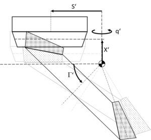

The tooth space shape of a non-generated ring gear is an exact copy of the cutting tool, a grinding wheel in this case. The relative position between the workpiece and tool is described by four parameters, the so-called plunging position, shown in Figure 4.1 and 4.2.
Figure 4.2: Modified plunging position.

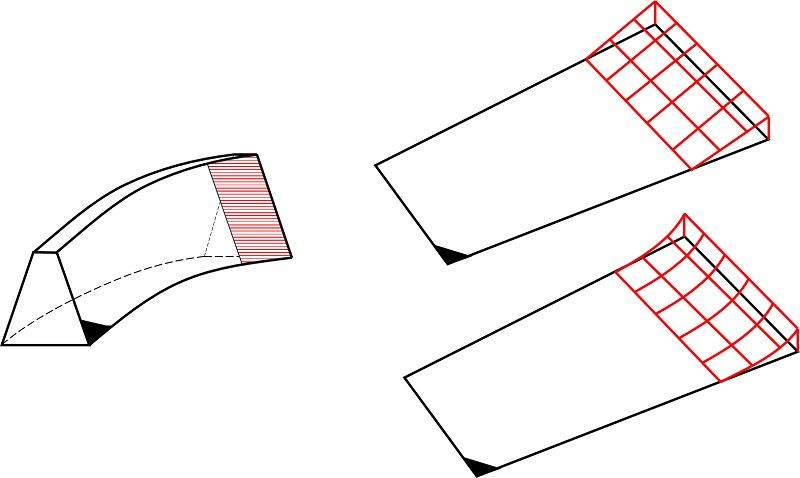

The four parameters are the infeed position X, the radial distance S, the cradle angle q turning the radial distance axis out of the drawing plane and the base angle. When machining the gear with the unmodified plunging position and subsequently machining with the modified plunging position, we get a flank form modification with a sharp kink in the face width direction, shown in Figure 5, upper right position. Modified Crowning now connects the modified plunging position with many intermediate plunging positions with a smooth machining motion. This allows a smooth transition of the original flank and the desired end relief, shown in Figure 5, lower right position.
Figure 5: Influence of several intermediate plunging positions connected by a smooth machining motion.
This example shows an end relief at the heel of the ring gear. But it is equally possible to apply an end relief at the toe of the gear. This is an essential feature of Modified Crowning for the design of a hypoid axle driven by an electric motor. The end relief will help to avoid the edge contact in the root toe area caused by the excessive displacements in recuperation mode.

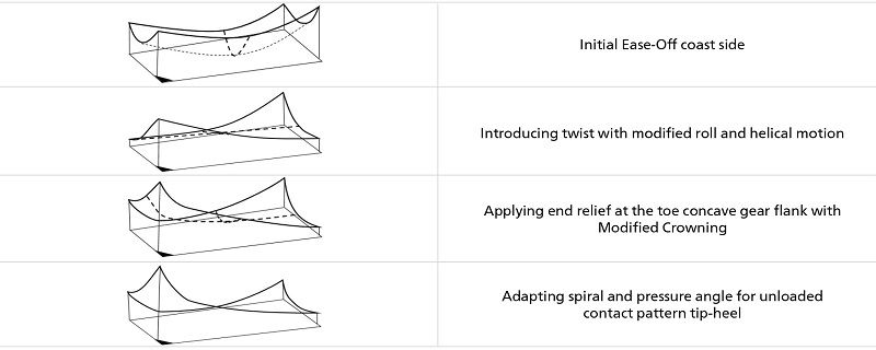

Figure 6: Steps in Ease-Off development.
Figure 6 shows the process of Ease-Off development. In the first step a large longitudinal twist is applied to the pinion flank using Modified Motion, e.g. Modified Roll and Helical Motion. The goal is to move the load bearing pattern from the tooth root of the ring gear to the center of the tooth. Next an end relief is applied at the toe of the gear with Modified Crowning. The last step is to align spiral- and pressure angle to place the unloaded contact near the tip close to the heel.
When performing these steps, we finally get an Ease-Off showing a very low unloaded transmission error and loaded contact pattern without edge contact.
