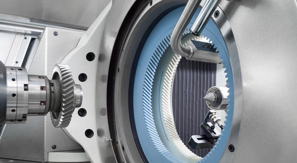

Gleason Combi Honing with two honing tools in one set-up, seen here as a polishing application.

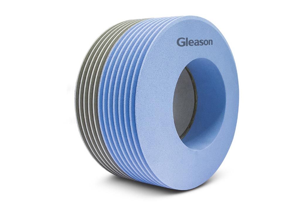

Two-zone wheel for polish grinding—zone 1 right (ceramic zone), zone 2 left (polish zone).
For fine finishing in one clamping, two zones of combination tools are used in generating grinding, both of which are ceramic-bonded, but with different grit types and, above all, grit sizes. Zone 1 is identical to a conventional, standard generating grinding worm, which performs the main cutting action during roughing. Finishing is performed exclusively in zone 2 with a finer grit size in order to achieve the required surface roughness and material contact ratio.
The procedure for gear honing is analogous, whereby a Gleason honing machine can accommodate two honing tools in the same, single honing head in a process called Combi Honing. It should be noted that zone 2 (i.e., honing wheel number 2) can also be produced using a resin bond.
Polishing is also carried out with a combination tool, although the polishing effect can only be achieved with a more elastic type of bond (polyurethane) and even finer grit.

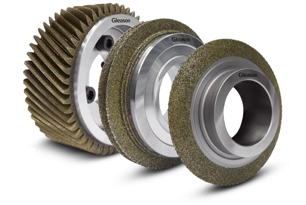

Development of this highly productive new generation of combination tools has also required that the bar be raised on the tools used to dress them. Whereas in gear honing the diamond-coated dressing tools are typically designed for a specific workpiece, generating grinding addresses a wider variety of applications. For prototypes, a universal shape dresser (GDU) can be used, which operates in point contact and thus maps any type of profile modification via machine kinematics. For smaller batch sizes, flexible tools (GDF) with a specific pressure angle and module range are used, which dress the grinding tool with a single flank. Workpiece-specific dressing systems (GDW) have an integrated tip dresser with a defined radius to avoid a step in the tooth root area or even to grind the full root radius.
All of the above dressing systems can also be used to perform Gleason’s twist-controlled grinding process without any further modifications.
Dressing tools for gear honing and gear grinding. From left to right: Diamond dressing gear for gear honing; workpiece-specific dressing disc system (GDW); and flexible dressing roll system (GDF) for generating grinding.
As one might expect, the performance requirements for dressing tools are significant, necessitating the use of a complete array of grain types and sizes and different bond systems, for applications ranging from an electroplated diamond dressing gear in gear honing to a dressing disc in generating grinding.
