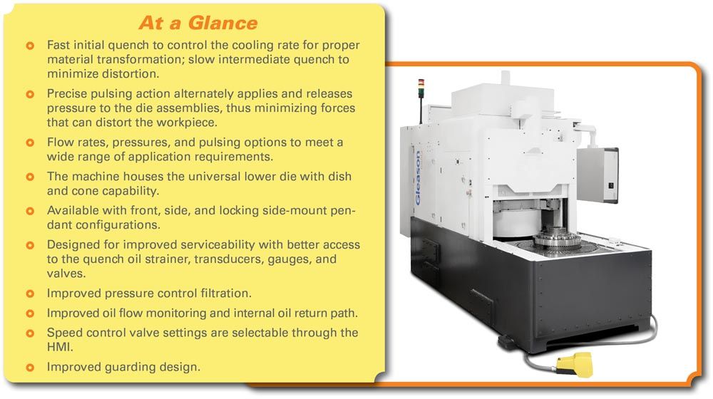

The 685Q offers increased productivity. With its Siemens Programmable Logic Controller, the 685Q significantly reduces setup and part changeover time. Automated setup ensures repeatability of all setup functions, including expander, inner/outer ring pressures, quench oil flow rates, cycle times, and pulsing.
Additionally, the machine has been designed from the ground up to deliver excellent part quality with minimum distortion and positive control of material hardness and uniformity.

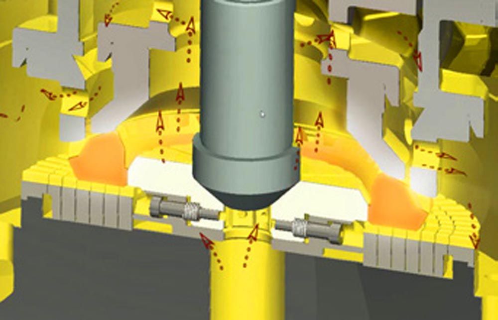

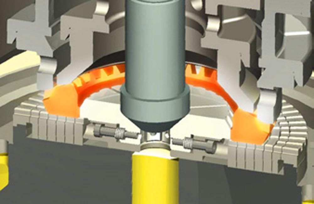

The pictures show an example of a standard automotive/truck ring gear being quenched in the 685Q machine. This type of design lends itself to the use of an expanding bushing for the centering of the part bore while two pressure rings make contact on the face of the gear during the oil quench process. Larger parts that have external teeth will have contracting bushing equipment to make contact with the outside diameter of the customer part. Customer parts with taller bores may have stacked expanding bushings to make contact along the whole bore, whereas smaller diameter bores will have a plug design that must be pressed out of the customer part post-quench.
Hot ring gear placed into expanding die with two pressure rings.
Quenched ring gear showing oil flow during the quench cycle.

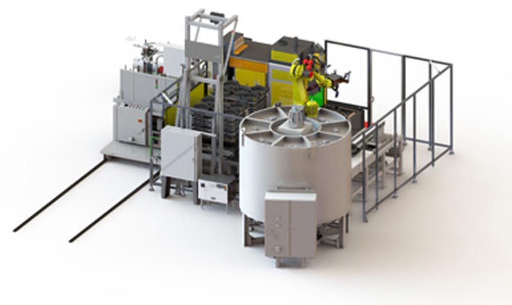

The 685Q is available with automation to speed part load/unload, whether operating as a stand-alone or for integration into a complete system or the customer’s existing production processes. A variety of automation solutions are available, in conjunction with Gleason Automation Solutions (GAS). GAS’s team works closely with the machine and workholding design teams to ensure that proper loading clearances and required features are factored into a total solution. Typical loader systems offer the loading of cold parts from the inbound rack storage, placement on the hearth, pickup of heated parts, movement to the quenching machine, and returning the quenched parts to outbound storage. Due to the nature of the quenching process and the need to transition a red-hot customer part to the die quench tooling already on the machine, appropriate measures are taken to ensure that the arm of the robot and any other ancillary equipment are protected from the heat of the part during the loading process. Note that all GAS loader systems include a vision system, which compares the actual part location to a known location. This information is communicated to the robot, which then can precisely pick up the part even if the part is out of its ideal position.
Gleason Automations Systems provides protective guarding around the loading area to provide a safe work environment.
