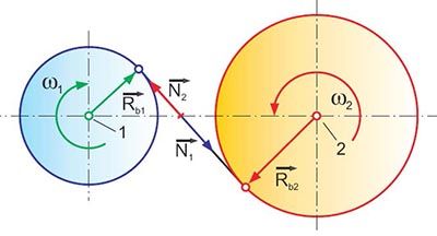

Based on the teachings of Figure 1, a flank form is wanted, whose vector product from radius and normal direction in any instant transmitting point remains constant during rotation (i.e., in any angular position). This flank form should favorably be developed without knowledge of the mating flank. The last claim becomes important in connection with profile shift and center distance change, which is the subject of a later section, “Generating the Involute.”
A crossed belt drive presents similar conditions (Fig. 2) (a straight line connects two circles).
Figure 2
Figure 2 Line of constant vector products.
- Click image to enlarge
The material elements of the belt, when shifted along the connecting straight line, result in a constant transmission ratio between disk 1 and disk 2. If one imagines finite surface elements whose normal direction in any case are consistent with the direction of the connecting line, then the requirements for a constant transmission ratio are fulfilled. The vector product only yields the perpendicular portions of the two multiplied vectors, which is why the solution for Equation 1 is given for any point along the connecting line as:
formula 1
where:
Rb1 radius magnitude of base circle 1
Rb2 radius magnitude of base circle 2

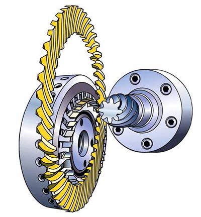

When the involute flank generation of cylindrical gears was applied to bevel gears in Figure 9, the trapezoidal gener-ating profile with plain “side walls” was used as the basis for the plain generating gear for straight bevel gears. The generating principle of conjugate flank pairs between pinion and ring gear works for a wide variety of flank length forms as long as certain rules are respected.
It is, for example, possible to expand the function of the straight tooth plain generating gear of Figure 9 to a plain generating gear with curved teeth and subsequently arrive at Figure 10. At the left side of the generating gear (Fig. 10), a cutter head is shown that has blades that are oriented a certain distance from the cutter head center, which represent one tooth of the generating gear. This arrangement allows for a continuous rotation of the cutter head that results in an efficient chip removal in the tooth slots. The teeth of the resulting spiral bevel gear are oriented under an angle to the radial orientation of the straight bevel gear teeth (Fig. 9). A radial section (with an axial plane) will cut through two or even more teeth. This means for the pinions and gears manufactured with the generating gear in Figure 10, that more than one pair of teeth is in mesh and participates in the transmission at any time. This effect, called the “modified contact ratio,” results in larger transmittable torques and a smoother rolling of the flanks.
Figure 10
Figure 10 Generating principle of spiral bevel gears.
An intuitive justification of the step from straight teeth to curved teeth is demonstrated in Figure 11.
Figure 10
Figure 11
Figure 11 Model for creation of curved teeth and explanation of spiral angle.
The straight teeth to the left (Fig.11, top) are divided into more and more segments; the segments are then rotated along the face width from left to right. An infinite number of segments with infinitesimally small rotations deliver eventually the spiral bevel teeth (right, Fig. 11, top). The definition of the spiral angle is demonstrated in the lower part of the same figure (the drawing plane is equal to the generating plane). The rules regarding the shape of the flank line curves (and pressure angle) that have to be followed in order to assure undisturbed meshing will be summarized in the second half of this chapter, which will appear in the next issue of Gear Technology. The second half also delves into more detail with regard to the different methods of generating bevel gear teeth.
