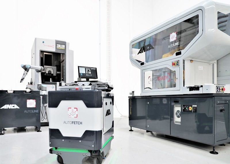

A fully operational manufacturing cell will be displayed at IMTS, demonstrating a fully automatic process of tool manufacturing, from blanks to ground tools. Included will be ANCA’s latest premium machine MX7 ULTRA capable of manufacturing high quality cutting tools, along with an AutoSet job preparation station, AutoLine for pallet and tool transfer as well as AutoFetch – a robot responsible for material transfer between processes - pallet and individual tools between job preparation, grinding and tool measurement on ZOLLER measuring machine.
Jan Irzyk, AIMS product manager said: “AIMS can be configured in many ways but at IMTS visitors can see an unattended manufacturing workflow of two varieties of endmills on one MX7 machine. An important part of this workflow is closed loop measurement and compensation process using Zoller Genius as a measurement station. Depending on an individual customer’s requirements, our system can automatically transfer a tool from the ground batch, clean it, measure required geometries and transfer the results to the respective grinder where grinding parameters compensation is taking place to achieve required dimensional tolerance of the batch.”
