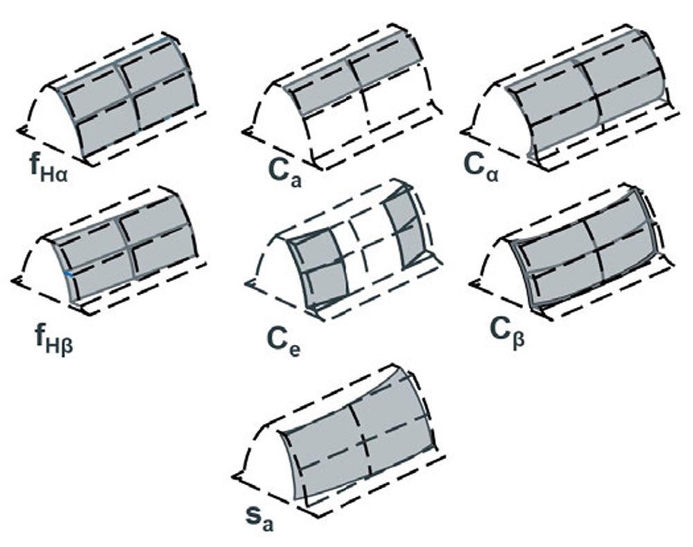

Flank Form Modifications and Imperfections
What is the reason for tooth mesh excitation? In the case of a perfect involute tooth profile, the mesh transmission error will be zero, i.e., no excitation exists. Because of manufacturing tolerances and load-induced deflections an unmodified involute profile and an unmodified lead shape will immediately show up with edge contact. Applying flank form modifications shown in Figure 2 can guarantee favorable tooth contact under all conditions.
Figure 2—Flank form modifications.
In particular tip relief Ca and end reliefs Ce are widely used for optimization purposes. Profile crown Ca and lead crown Cb have a significant influence on the mesh transmission error and should be kept small.
It is obvious that a gear design engineer has to compromise the mesh transmission error and the amount and type of flank form modifications required by the load-carrying capacity of the gears. Gears being highly insensitive to displacements and load-induced deflections require larger modification amounts. Hence, they provide a larger mesh transmission error with higher excitations to the transmission assembly.
