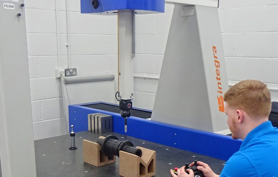

The metrology department continued in this vein, adding a new LK INTEGRA 10.10.8 with a measuring volume of 1.0 x 1.0 x 0.8m in 2007 for quality control of smaller, tight-tolerance aerospace parts and tooling. The machine was purchased through Metris, which owned LK at the time, although the company has been independent again since 2018.

In day-to-day operation, the ALTERA M CMM supports the inspection of large parts with drawing tolerances of typically ± 50 µm but is sufficiently accurate to measure smaller parts down in the 10 µm region. Irrespective of tolerances, LK’s software application CAMIO with its user-friendly operator interface allows CNC programs to be generated either online or off-line for the inspection of batch quantities, further reducing inspection time and cost, especially when CAD models are available.
"Across the broad spectrum of work packages, we have access to CAD models approximately 50-60% of the time, with the remainder being work-to-print. However, the provision of CAD models is something we are always encouraging our customers to provide, as it minimizes the risk of incorrect data being entered due to human error during the programming process," Reeves said. "LK’s CAMIO software also saves time by automatically generating comprehensive reports that we are able to send to our customers with inspected components. The professional appearance of the documentation adds to the perceived professionalism of the service we provide."
“The new metrology platform is significantly more productive than our old G80K and the G80C put together, as well as being more accurate. Along with the INTEGRA, it puts Park Engineering in a good position to provide metrology support not only to our own production, but also to external customers that want subcontract measurement support now and into the long-term future,” he added.
