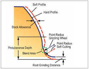

Also, grinding of root relief, the so-called blended Toprem®, leads to a critical condition on the grinding wheel because the small, sensitive tip of the grinding wheel might have to remove 10 -30% more stock than the main profile section. Heavy material removal of the tip of the wheel causes a deterioration of the protuberance section and the edge radius after grinding only several slots. Subsequently, the remaining slots have lesser or no root relief and an unacceptable blend into the root-fillet radius. This effect cannot be cured by redressing after some number of slots.
An important part of the semi-finish strategy for modern bevel gear grinding is the root fillet area that is not ground. The optimal protuberance of the cutting blades relieves the transition between flank and root by a value equal to the stock allowance on the active flanks. The cutting blades should have an edge radius 0.1 mm smaller than the edge radius of the final grinding wheel profile. They also should cut 0.1 mm below the theoretical grind depth.
The transition between the grinding profile and the unground root area should be optimized on the drive side of both members, using a grinding wheel tip extension and a setover, to get a smooth blend of the ground to the unground root surface and clean up the root radius to the area of 30° tangent.
The distortions due to heat treatment cause an unequal cleanup along the face width and from slot to slot around the circumference. Also, the first- and second-order corrections, applied after coordinate measurement to achieve a correct flank geometry, influence the angle of the ground root line versus the semi-finish cut root line. This root-angle difference might result in a partially ground root bottom.
This result is no problem as long as the slots’ average length of ground root bottom is no more than 30%. Variations in cleanup can result in as much as 70% of a single slot’s root bottom being ground. Such a high percentage in a single slot is acceptable, though. In that case, a slot’s root geometry variation would be as much as 100 microns. Variation up to this amount in a slot will not adversely affect the performance of the gear set. Still, the average cleanup percentage of all slots can’t be more than 30%.
