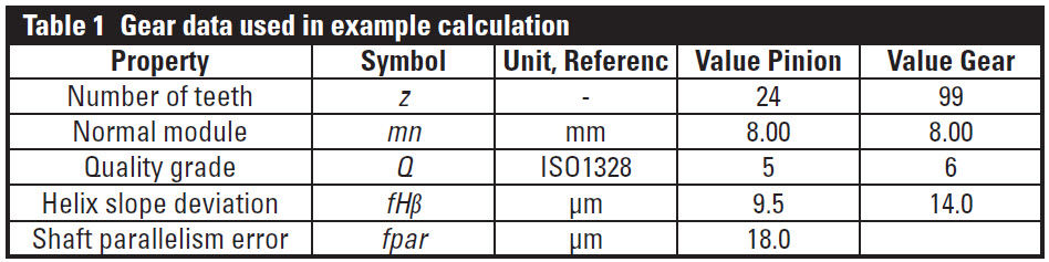

The errors fHβ1 and fHβ2 can either be measured and averaged values from production or they can be determined from the gear quality number Q; e.g. — Q = 6 (gear quality 6 as per ISO1328). The error fpar is more difficult to determine, as it not only considers the misalignment of one shaft to the other due to the misalignment of the housing bores, but it should also consider variations in bearing operating clearances and the misalignment between the gear pitch cylinder with respect to the corresponding shaft axis. For the sake of simplicity, let us assume the housing bore arrangement is tolerated in such a way that we know the permissible shaft or gear axes parallelism error from the manufacturing drawing.
All errors are considered as random and the mean is zero (e.g. — tolerances given in drawing are symmetrical). The errors are hence described as a tolerance around zero, i.e. — fHβ1 = ±a, fHβ2 = ±b and fpar = ±c where a, b, c are values in micron.

Applying the above formulas we find that the resulting tolerance range ±d if we apply 3-Sigma Rule as:
And if we apply a worst-case scenario, we find:
Considering the above statement that the worst-case approach is considered as overly conservative, then, for the above gear pair, we would consider a random manufacturing error in the mesh of fma = ±d = ±24.7μm, when calculating KHβ along ISO6336-1, Annex E.
